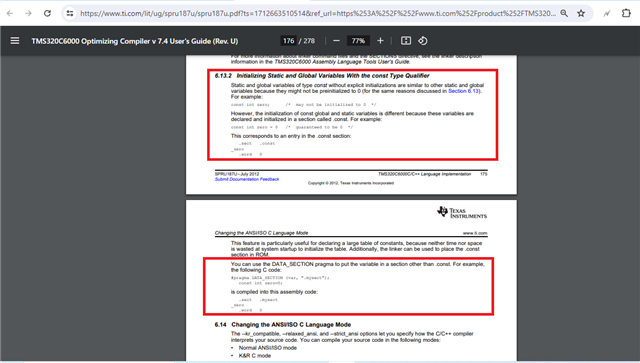

我现在使用的TMS320C6657的开发板,使用sys/bios,双核,单镜像程序,我是在程序中通过DNUM来区分核0 和 核1运行的代码段的,但是我现在遇到一个问题,就是我没找到方法把核0核1的全局数据定义在不同的DDR内存段中,我知道可以先用平台把DDR内存分成不同的段,但是我不知道怎么把这些数据分配在不同段?数据包括全局变量和任务里申明的局部变量

  • The development board I am currently using, TMS320C6657, uses sys/bios, dual core, and single mirror programs. I use DNUM in the program to distinguish the code segments running on Core 0 and Core 1. However, I am currently facing a problem where I have not found a way to define the global data of Core 0 and Core 1 in different DDR memory segments. I know that the DDR memory can be divided into different segments using the platform, but I don't know how to allocate this data in different segments? The data includes global variables and local variables declared in the task

    We have to use the linker.cmd to define our memory map and its sections.
    For example:-

     *  Linker command file
    -c
    -heap  0x41000
    -stack 0xa000
    /* Memory Map 1 - the default */
    MEMORY
        L1PSRAM (RWX)  : org = 0x0E00000, len = 0x7FFF
        L1DSRAM (RWX)  : org = 0x0F00000, len = 0x7FFF
        L2SRAM (RWX)   : org = 0x0800000, len = 0x080000
        MSMCSRAM (RWX) : org = 0xc000000, len = 0x100000
        DDR3 (RWX)     : org = 0x80000000,len = 0x20000000
    SECTIONS
        .csl_vect   >       MSMCSRAM
        .text       >       MSMCSRAM
        GROUP (NEAR_DP)
        .neardata
        .rodata
        .bss
        } load > MSMCSRAM
        .stack      >       MSMCSRAM
        .cinit      >       MSMCSRAM
        .cio        >       MSMCSRAM
        .const      >       MSMCSRAM
        .data       >       MSMCSRAM
        .switch     >       MSMCSRAM
        .sysmem     >       MSMCSRAM
        .far        >       MSMCSRAM
        .testMem    >       MSMCSRAM
        .fardata    >       MSMCSRAM
        platform_lib > 		MSMCSRAM
    Once you build your program, a "*.map" will be created, in which we will be able to see the memory configuration, section allocation map and global symbols etc...

  • The data is defined in L2SRAM or MSMC, but now I need to define it in DDR, such as a single mirror program with the same global variable testA. How to define this in different DDR memory segments
    You can change the sections and re-direct to the memory according to your needs.
    DDR3 is the one you have to refer to and focus on
    For more details refer to the following docs.
    https://www.ti.com/lit/ug/spru187u/spru187u.pdf
    https://www.ti.com/lit/ug/spru186w/spru186w.pdf
    Shankari G
