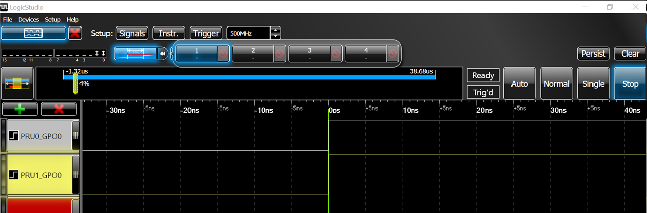

  • Hello Ma Tianfu,
      I have implemented and tested the scheme to sync PRU0 and PRU1 using task manager. PRU0_GP0 and PRU1_GPO0 come out in sync with skew < 1ns.
    Here the source file in PRU assembler project. I am using compiler defines PRU0 and PRU1 to build out file for both PRUs.

    Let me if you have any questions.
    BR,
      Thomas
