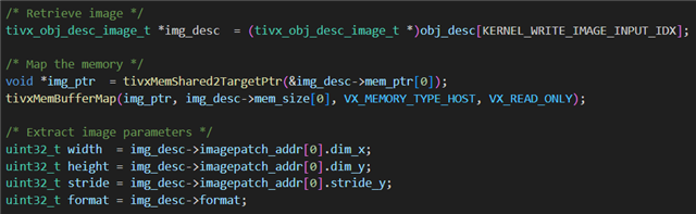

And I write the image as follows in a custom CPU targeted node

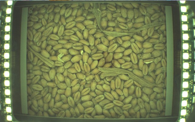

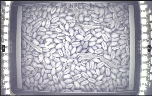

    Finally, when I captured the C1-C3 output, I got the following images.
    (raw output)
    (after white balance, based on a known color strip)
    As you can see, the problem here is that the color contrast is not correct. A correct image looks like this:
    (before whitebalance)
    (after whitebalance)
    We can get a correct image from using the OpenCV debayering process (GR bayer format) in Python, but not with the VISS node. I have attached a raw image here for you to try on.
    This is a binary U16 format in bayer GR (following OpenCV standard), we sometimes use GB format since this only switches the red and clue channel. Using GR will generate a blue-ish image, using GB will generate a green-ish image like above.
