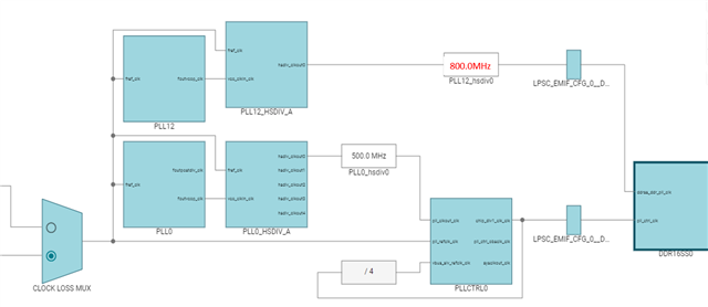

In case of using DDR4-1600MT, the clock from PLL12 is 800MHz.
Am I correct in understanding that the clock is 800MHz in this configuration?
I have checked as follows, but just to be sure, please let me know if you have any concerns.
Kanae
  • Kanae, no, PLL12 HSDIV0 should be 400MHz.  This will yield a memory clock of 800MHz, and data rate of 1600MHz.  There is a separate PLL in the DDR subsystem which produces the 2x and 4x clock frequencies that are required for the DDR controller and PHY to operate.

    1. PLL12 HSDIV0 is a fixed value of 400MHz?
    2. Is my understanding correct that the PLL12 HSDIV0 doubles 400MHz with the DDR subsystem PLL
     to generate 800HMz?

  • 1. Yes, it will be a fixed value if you choose 800MHz memory clock operating frequency in the DDR register configuration tool.  Other frequencies will have a different PLL configuration, but the PLL will always be half of the memory clock frequency
    2. Yes
    There is nothing that configures the DDR PHY PLL.  This is inherent in the design.

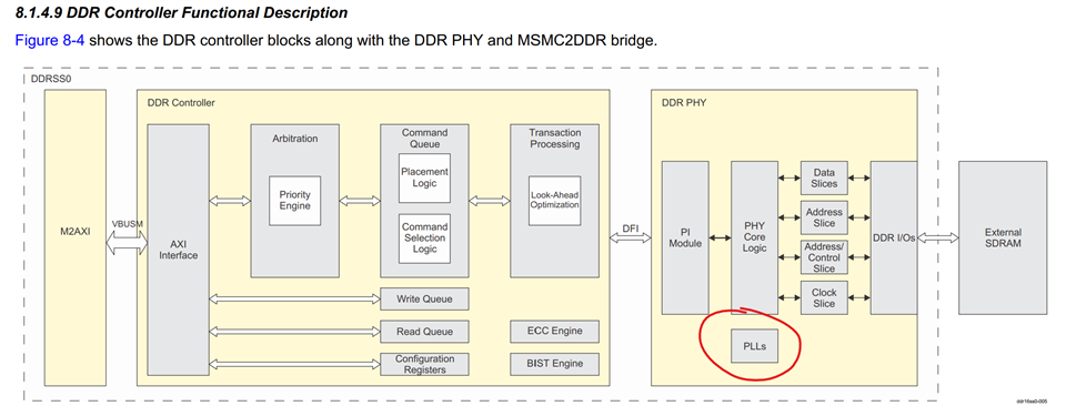

  • Kanae, this would be in a internal design doc which i cannot share.  However, the PLLs are shown in the block diagram in the TRM.
    James
