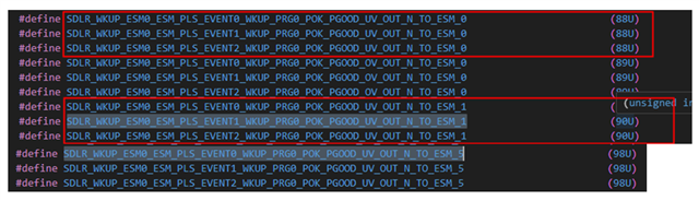

After analyzing the ESM error from the log, we found that these error are WKUP ESM error index 88, 90, 98 shown below.
Could you help provide some suggestions on what could cause these problems?

  • Hi Kevin,
    These are the events for VDDSHV Main 1P8 Under Voltage (SDL_POK_VMON_EXT_MAIN_1P8_ID) and VDDSHV Main 3P3 Under Voltage (SDL_POK_VMON_EXT_MAIN_3P3_ID).
    Josiitaa
  • I have measured the "VDDSHV MAIN 1P8" and "VDDSHV MAIN 3P3" circuit, and the voltage values displayed are normal.
    Therefore, I am wondering whether the above ESM error is possible to be wrong positive. Or is there something wrong with my initialization code that causes an error?

  • Hi ,  Here just config it to good value and enable it
  • And I config  POK  to other value, but  the instance 4, 5, 6(picture 1 shows the meanning) error always occured, and instance 1~3, 7~13 was disappeared.   In picture 2, we can see  that.

  • think you.  And  we set have delay function to 1ms, but not help
  • closed ,  our HW board error.
