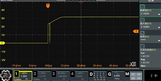

There is low pulse for PORZ_OUT, when we do measurement with AM6422.
The detailed wave as below, please help to if it is the right action for AM6422, or if there is any risk or problem for this signal.

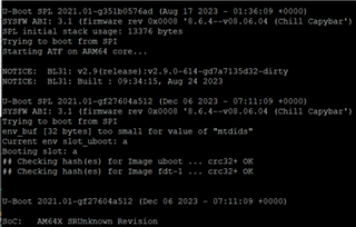

From the timing, looks like the workaround in the boot code fix MDIO issue of errata.
U-Boot SPL 2021.01 (Jul 31 2023 - 11:31:58 +0900)
Resetting on cold boot to workaround ErrataID:i2331
resetting ...
SYSFW ABI: 3.1 (firmware rev 0x0008 '8.4.7--v08.04.07 (Jolly Jellyfi')
SPL initial stack usage: 13424 bytes

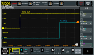

Hi Sreenivasa and Tony
Customer tested Resetstatz and the MCU_Resetstatz outputs along with the PORz_Out:
Regarding the boot code, do you mean it’s the code in ROM?
Customer didn’t find same errata log from their serial port message:

I cant see the PORz_OUT pulse.
Please confirm.
Sreenivasa
Hello Sreenivasa
Please see the PORz_OUT picture on below reply
Below figure is the waveform during power up (MCU_POR is blue, PORZ_OUT is yellow):
Hello Ethan,
Thank you.
I do not see the pulse that you initially reported initially in the PORZ_OUT is yellow waveform. Any thoughts.
Sreenivasa
Hi Sreenivasa
The time interval on the PORz_OUT horizontal axis of the picture with pulses is 500us, and the time interval of the subsequent picture is 50ms.

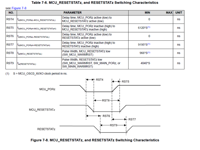

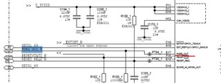

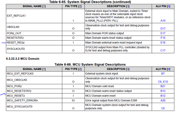

I see a difference of 200 mS between PORz_OUT and the RESETSTATz, MCU_RESETSTATz
Can you please check if the MCU_RESETz or RESET_REQz is being controlled by an external input?
Sreenivasa
Hello Ethan,
Thank you.
Please refer the expected waveform at the output after MCU_PORz
