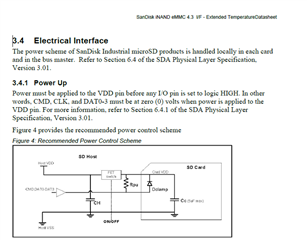

    Also: While I have your attention: MMC1 controller VDDSHV8, and the SD card is pulled up to LDO1 (3.3V). The SD card power is enabled by REGEN1. There are 2.5ms between REGEN1 and LDO1 coming up. I observe that LDO1 is coming up about 7ms before the SD card is powered up. This violates the SD card spec. The SD Card should be powered up before the SD Card IO pins have Voltage, but it seems to work. As far as I know I am not using UHS mode. Is it safe to power the SD card from LDO1?
  • I don't have the SD card spec available to verify.  LDO1 possibly used to power both VDDSHV8 and VDD of SD card if it has the current capacity (not use SD card power requirements) and if supply is fixed 3.3v (not using UHS-I modes that switch to 1..8V)
  • I don't have the SD Spec either. I found the information in SanDisk industrial SD Card Datasheet.  Using LDO1 is risky. LDO1 can output 300mA max The SD Card is 150mA or 200mA for 50MHz. I have no idea what the SW is doing.  How much current dies the MMC1 controller draw?
  • The MMC1 controller is not powered by VDDSHV8, only the IO cells.
  • I should have enough current capacity.
