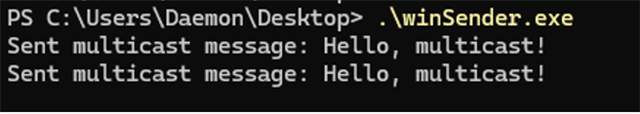

We found that for the multiple PRU ethernet ports connected situation, there is possibility that the broaIdcast packet will loss.

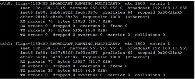

For example, if we connect eth0 & eth1, the ip address of eth0 and eth1 is shown below.
Then, we use PC to send the broadcast packet shown below.
In the normal situations, their testing code will print eth1 continuously shown below.
We use wireshark to catch the corresponding IP igmp packet shown below, and could confirm that the IP of this packet belongs to eth1.
In the unexpected situations, their same testing code will print eth1 continuously shown below.
We use wireshark to catch the corresponding IP igmp packet shown below, but we found that the IP of this packet belongs to eth0.

    From a general ethernet perspective, when two ports (not configured as a switch) are on the same subnet, usually eth0 (not eth1) would respond to any ICMP messages even if eth1 interface was specified. This is the case for CPSW ethernet (two external ports, one internal port, and single driver controlling both external ports). I'm currently not sure if 1. pru_icssg ethernet would have the same subnet issue and 2. whether the fact that multicasting is used here changes the behavior.

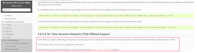

    However, we found some features of TSN in PRU ethernet ports are not supported including FQTSS/CBS
    Is this finding the result of testing out FQTSS/CBS on the PRU ethernet ports or just through reading the SDK documentation? I noticed that https://software-dl.ti.com/processor-sdk-linux-rt/esd/AM64X/latest/exports/docs/linux/Foundational_Components/PRU-ICSS/Linux_Drivers/PRU_ICSSG_Ethernet.html?highlight=tsn#time-senstive-network-tsn-offload-support indicates there is offload support for IET and EST but no indication to whether FQTSS/CBS is offloaded. This does not seem to say we don't support FQTSS/CBS on PRU ethernet just that it's not offloaded.

    Correct, ICSSG based Ethernet does not support FQTSS/CBS/802.1Qav. There are no plans to add this to ICSSG, use CPSW based Ethernet for Ethernet AVB.

    I noticed this as well. eth0 and eth1 are on the same subnet 192.168.13.x mask /24 from the same Linux instance and one networking stack. This is not something that should be generally done and how does a broadcast in this case behave is not clear.
