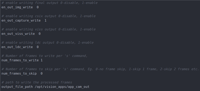

We have connected 2 cameras to CSI1. When run_app_multi_cam.sh is running, we want to press 'S' and save the capture image locally.
How to enable the save image function in the app_multi_cam demo we are currently using?
How do we need to modify the code?

  • Hi Barry,
    In order to save an image by press "s" in multi-cam demo, all you need is to enable the flag "en_out_capture_write" in app_multi_cam.cfg present in vision_apps/apps/basic_demos/app_linux_fs_files/vision_apps_evm/
    also, please note that you would have to create app_cam_out folder in /opt/vision_apps/ on the SD Card for the images to save.
    After this, when you run the application and press "s", you'll save the images.
    Nikhil

    What is certain is:
    # Number of frames to write per 's' command,
    num_frames_to_write 1
    Why does each channel data we save always seem to have two images? What is the reason?
    What should we do to save only one 1920x1536 image per channel?
    Looking forward to the experts’ help, thank you
    Barry
    Looking forward to the experts’ help, thanks
    Barry
