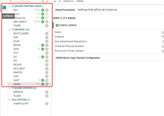

When using the TI AM62Ax R5 SDK to debug routines, it was found that the same Sysconfig in the routine cannot meet the needs of debugging multiple drivers. As shown in the figure below, neither sysconfig can meet the needs of debugging MCAN and DMA simultaneously.
1. May I ask if it is possible to add TI drivers based on this sysconfig. (If possible, please provide a method)
If 1 is not feasible, can we provide a course of action for this issue.

  • Hello Tushar,
    Thanks for your response.
    For example, this r5fss0:0 routine contains most of the drivers I want to debug, but there is no MCAN driver. Can I add an MCAN driver in some way?
    Ding
  • Hello Ding,
    Currently, MCAN peripheral is only supported through MCU R5F and A53 core. Please refer MCAN_loopback_example.
    Tushar
  • Hello Tushar,
    As shown in the figure below, is there a way to add MCAN to the TI Drivers list in the reserved driver list to meet my development needs.
    Tushar
  • Hello Ding,
    The Reserved Peripherals tab is used to reserve any particular hardware resource that your own custom code will handle, and it tells the sysconfig tool not to use that peripheral. This tab should not be used for any peripherals that you want to be configured by the tool.
    Tushar

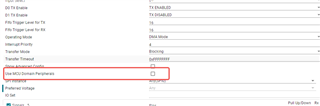

  • Hello Tushar,
    Thanks for your reply.
    When debugging with mcu-r5fss0-0, can resources outside of MCU Domain be accessed without checking the Use MCU Domain Peripherals option.
    Ding
  • Hello Ding,
    Yes, but you can only access peripherals outside of MCU domain which are supported/accessible by the MCU core by unchecking the use MCU domain peripheral option.
    To check the list of peripherals supported by each core please refer mcu-sdk-release-notes.
