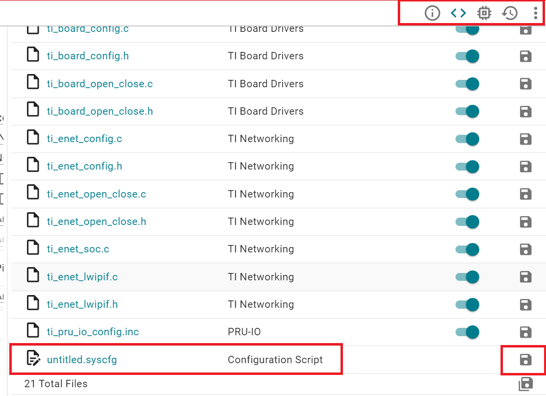

  • Hello Nakano,
    I assume you might be using MCU+SDK for development. Each example provided in the MCU+SDK contains example.syscfg file which is responsible for the generation of ti_pinmux_config.c file. You can also edit the example.syscfg itself in the CCS and generate those files.
    To use the configurations done on Sysconfig cloud based tool, please save the generated untitled.syscfg file as shown in below screenshot.
    Now remove the example.syscfg file already present in the the project and copy the untitled.syscfg file.
    After copying the file to project, rename it to example.syscfg.
    Rebuild the project, the file ti_pinmux_config.c will be auto generated in the project.

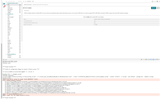

  • Hi Tushar,
    Thanks for the procedure. The customer followed the steps but they got error message below.
    After hitting yes for retry, then another error message showed up.
    another error message came up and says; unknow property: $useCase.
    Ifs there any file format difference btw WEB based Sysconfig and CCS?
    Nakano

  • Hi Tushar,
    Please find the details below.
    Nakano

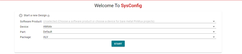

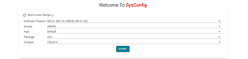

  • Hello Nakano,
    Thanks for sharing the above details.
    I can see the file shared above is created with the below setting in Sysconfig Cloud tool. The above file is created without a selecting the software product field. Please refer below screenshot.
    The file generated by using above field selection cannot be used with MCU+SDK projects/example as they are not compatible with the generated file.
    Please create a syscfg file by selecting Software Product field with appropriate MCU+SDK.
    Tushar

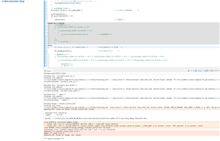

  • Hi Tushar,
    Thanks for your best support. Now customer can use WEB sysconfig file on CCS sysconfig but, they see some compile errors below.
     DO you see the same error when you compile?
    Nakano
  • Hello Nakano,
    Thanks for your reply.
    From the error logs it is seen that the symbol putchar_ is undefined. Please see the below image.
    Can you please make sure, have you imported all the necessary libraries?

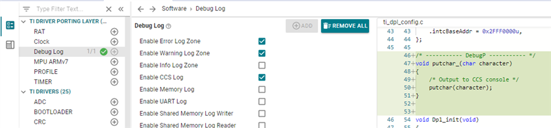

  • Hello Nakano,
    From the above logs, it is seen that the error is encountered during linking phase. The symbol putchar_ remains undefined during the linking of the program.
    The definition of the putchar_ function is auto generated by the Sysconfig tool when you configure the Debug Log section in the example.syscfg file.
    The tool generate the ti_dpl_config.c file which contains the definition for putchar_ function.
    The example.syscfg file used by the customer does not have this definition of putchar_ function in the generated ti_dpl_config.c file which results in linking error because the putchar_ symbol is not defined.
    Hope the above information helps.
    Tushar
  • Hi Tushar,
    Thanks for your reply.  The customer simply need to select "Debug Log" for putchar_ difined, correct?
    Nakano
  • Hello Nakano,
    Yes, but the Sysconfig tool will not generate any code for the resources which are configured under reserve peripheral tab and the example will not work properly.
