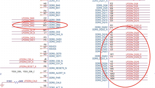

  • More Infomation:
    This is on our custom board.HW design is different from EVM.
    Our custom board make byte swap in data line:
    Our board:
    EVM Board
    Besides,our core voltage is 0.85v different from 0.75v on EVM.
    Changes in board_ddrReginit.h have been made according to HW design using ddr config tool.
    5165.board_ddrReginit.h
    Other configure modifications also have been made in dtsi file.
    I also tried to lower ddr frequency but made no difference.
    Please help us to make double check of the config parameters.
    Thanks!
