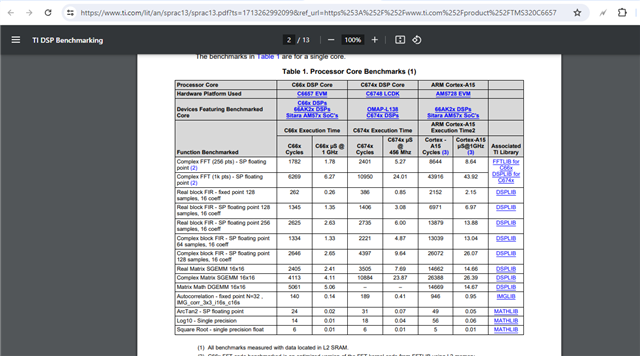

  • Chen,
    Let me try to measure the GPIO interrupt latency.
    By the way we have benchmark details for using the DSP lib functions like FFT etc..
    https://www.ti.com/lit/an/sprac13/sprac13.pdf
    Shankari G

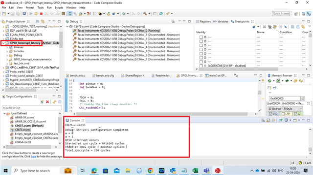

  • Chen,
    yes, I have experimented the GPIO interrupt and GPIO-interrupt latency....
    Measured the clock cycles between the GPIO interrupt occurrence to the GPIO ISR ( Interrupt service routine).
    For me, it takes, 210 CPU cycles.
    Total no of CPU cycles =    cycles
    DSP core frequency = 1000 MHz ( I ran the DSP at 1000 MHz)
    Time = 1 / Freq ( General formula )
              = 1 / 1000 MHz ( DSP core frequency )
              = 0.001 us ( Micro seconds)
    1000000000 cycles = 1 sec
    => 210 cycles =  0.210 Micro seconds.

        while(a!=1){}
        EndTime = utilReadTime64();
        printf("a = %d\n",a);
        printf("GPIO interrupt occurs\n");
        Total_cycle_ticks = EndTime - StartTime;
        printf("Started at cpu cycle = %llu cycles \n", StartTime);
        printf("Ended at cpcu cycle = %llu cyclces \n", EndTime);
        printf("Total_cpu_cycle = %llu cycles\n", Total_cycle_ticks);
        return 0;
    Output Screenshot:-
    Shankari G
