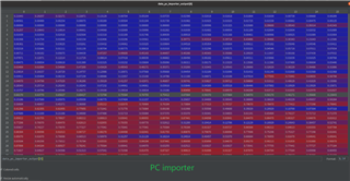

I encountered some exceptions while verifying the output of the sigmoid layer. The PC importer process of the model is correct, and the results of the PC importer are shown in the following figure,The input of the sigmoid is INT16, and the dimension is 59 * 44 * 16
I used the same input to validate on TDA4VH, but got an abnormal result with an output dimension of 59 * 44 * 16. However, the [: 29,:,:] parts of the board end result are all the same data and have not changed (there is a significant difference in the PC importer result)
