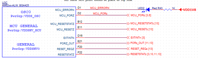

  • The relevant SCH are as follows:

After pressing the reset key, the MMC0_CLK clock waveform is measured as follows. Pressing the reset key the initial clock waveform is the same as the power-up. start the dynamic frequency modulation and the system starts up normally; press the reset key and after the initial clock, the MMC0_CLK becomes a stable 25-MHz clock. the system does not boot.
The CMD waveform is constantly measured while the power-up and reset keys are being measured
Please help see why reset gets stuck and does not work
