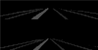

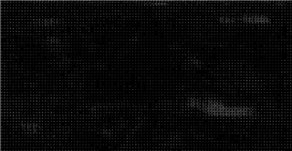

Hi, ti exports,
we transformed the same onnx model into ti bin model respectively by 9.1 tidl_model_import.out and 9.2 tidl_model_import.out
why are the bin models verified with different outputs as follows:
9.1 verified output                                                  9.2 verified output
The same source bmp file is used by both import process
