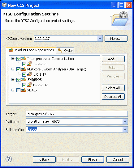

    • In the RTSC Configuration Settings
      • Platform = ti.platforms.evm6678
      • Build profile = debug  (NOTE: the UIA package no longer provides pre-build binaries for whole_program or whole_program_debug build profiles)
      • Click Finish

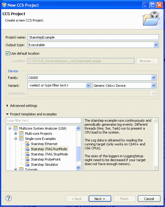

    If you're planning on using BIOS, the simplest way to show the CPU Load Graph and CPU Execution Graph in action is to build a New CCS Project that is based on the Multicore System Analyzer / Single-core Examples / Stairstep JTAG RunMode template:
    Be sure to change the Build-profile to debug (or release), and to then to set the Build Configuration for the project to the same thing (e.g. to build the 'release' build profile, right click on the project in the Project Explorer, select Build Configurations ->Set Active->Release).  Then build the project - it should build without errors.
