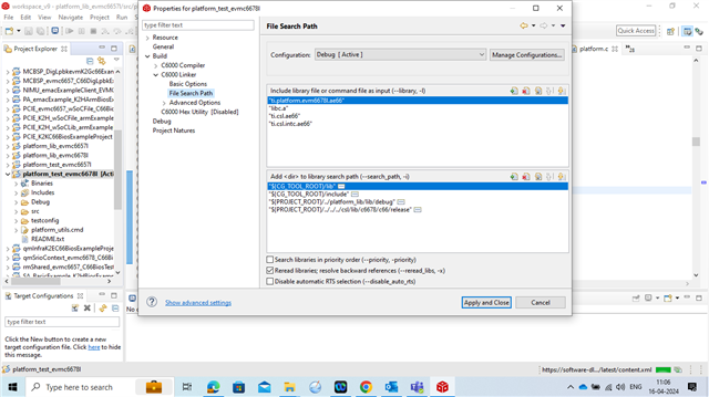

I have rebuild the ndk 2.21.02.43 for C6678,but get the library without the same size of the ndk installed.how to rebuild the ndk to get the same library files like ti released?

Hi @Shankari G i have download the ndk 2.21.02.43 and copy the ae66 lib files to my user project,rebuild my user project it works well.but if i rebuild the ndk,and then copy the ae66 lib files to my user project,rebuild my project ,it shows some errors.
Eric,
Your screenshot shows, it is an linker error.....
In CCS, right click on the project and go to project properties--> Build ---> C6000 Linker --> File search path ---> Include the file name and the path.
Something like below:-
Shankari G
the filse search path is correct.the difference are the ae66 lib files.if i used ae66 lib files from ti ndk install directions ,my project can build without errors.but if i replaed the ae66 lib files (i rebuild the ndk),my project will build errors.
