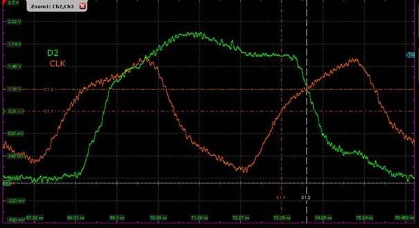

In the spec of eMMC, it is required that the minimum data hold time should be 0.8ns. But in the actual measurement, customer find the hold time of the most data lines cannot meet this requirement. So customers would like to know if we can adjust some parameters/registers to make the timing in the spec? Thanks
DAT[0]0.5963ns
DAT[1]0.6972ns
DAT[2]0.6039ns
DAT[3]: 0.519ns
DAT[4]: 0.85ns
DAT[5]: 0.8448ns
DAT[6]: 0.627ns
DAT[7]: 0.752ns

    Thanks for providing some examples of the input timings you have captured. It does seem like the measurements vary quite a bit since the lowest one was 0.519ns and the highest was 0.85ns.
    First I'd like to ask how is this being measured and standardized? It also seems like the waveforms aren't super well defined and have a bit of static. I would recommend using tip and barrel measurement for the most clear waveform. Another thing to look at is to make sure the trace length follows the spec for our board which could help with a clearer waveform as well.

  • Hi Matt,
    Thanks for your reply. Customer has provided the clear waveform as attached. They measure the signal close to the pin and follow the eMMC spec to capture the measure point.

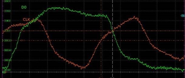

  • Hi Xingyu,
    Could you provide a screenshot of the timing waveform like previously? Thank you.
    Matt
  • Hi Matt,
    Please check below screenshot.

  • Hi Xingyu,
    Thanks for your patience. After discussing the waveforms with my team, we found that the clock STARTING to transition and the data STARTING to transition is 1.2ns - 1.5ns in your screenshots. Therefore, the small hold time you are measuring is due to the non-ideal slope/shape of the measured waveform transitions.
    Some of the non-ideal transitions can probably be attributed to measurement artifacts (probe point location, probe ground location). You could run an IBIS simulation on the system using ideal probe points (directly on the eMMC pins) to compare against their measurements.
