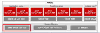

Customer is trying to put a small application run by R5f in the 2MB SRAM shown below.
We think the execution speed is the same as the corresponding clock for the SRAM.
Could you help to check if this speed is the same as R5f 800Mhz, or it will reduce to 400MHz or any other values?

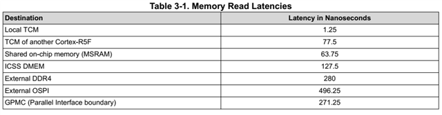

    If you have INSTRUCTION data saved to SRAM, the speed of execution for the code will drop to however many clock cycles it takes the R5F to retrieve the next instruction from SRAM. Accesses to the Instruction RAM (IRAM) of the R5F core are single cycle, so the instructions execute at the clock speed of the processor. However, if the R5F is accessing instructions that are stored in SRAM, it will only be able to execute one instruction per the time it takes to access the memory.
    https://www.ti.com/lit/spracv1 section "Memory Read Latencies" shows that we measured it takes 64 nanoseconds (best case) to read a 32 bit word from SRAM to an unspecified R5F. Let's say you are running the R5F core at 800MHz. Then the absolute FASTEST you could run while reading instructions from SRAM is about 1/64ns = 15MHz, or more than 50 times slower than if you were running instructions from the R5F subsystem's internal memory.

    instruction cache actually greatly improves latency when grabbing instructions from SRAM, because you "pay" the SRAM read latency only once per cache line, even if the instructions were not yet in the cache. So 64ns latency + 1,25 per additional instruction that can be used, for better average cycles per instruction.

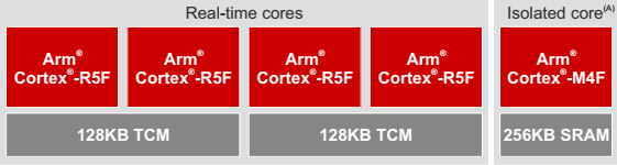

    On the R5F you don't really have "IRAM" (I believe that's a Cortex-M term), but two banks of TCM.
    If the customer is concerned about high speed SRAM accesses, there's the option of using a r5fss in single core mode for twice the TCM (i.e., instead of dividing the TCM in an R5F subsystem evenly across two R5F cores, only enable one core so that it can use all of the TCM in the subsystem).

    3.Local TCM means R5F0_0 R5F0_1 share the left 125KB TCM, R5F1_0 R5F1_1 share the right 125KBTCM. Is my understanding correct?
    Yes. Each subsystem has 128 KB of TCM, or 64 KB per core. If you put a subsystem in single-core mode, you get 128 KB of TCM for that single core. You really only have the option of "64 KB each" or "128 KB and just one core".
