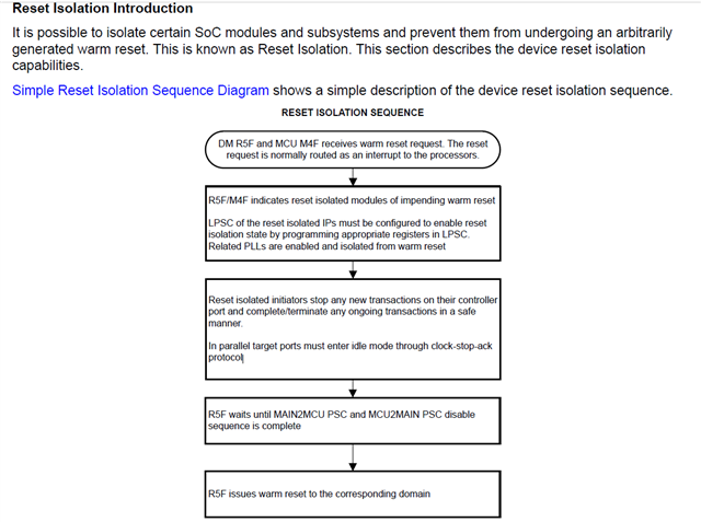

I found in TRM, there is description in 6.3.4.2 about reset isolation, aiming at prevent modules or subsystems from undergoing reset from watchdog.

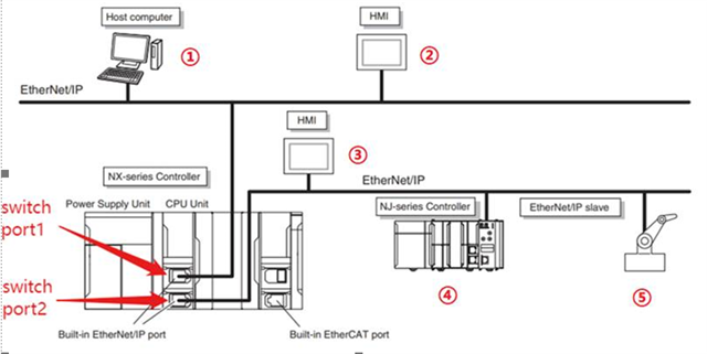

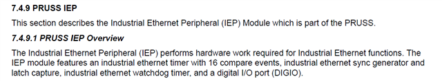

Here is my question, if soc receive a reset from watchdog, is is feasible to reset board without ethernet switch in PRU, so that external device won't be effected?
