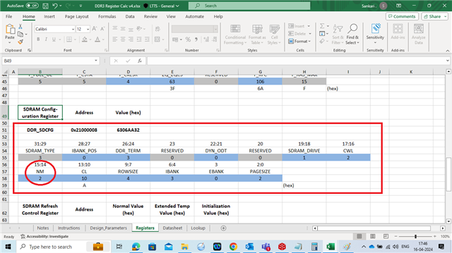

If im using TMS320C6655 (no ECC usage) with single DDR: 4Gbit (256Mx16bit)
DSP had 32-bit width and I using only 16-bits, does 16-bit DDR limit the DSP throughput?
My concern is from possible DSP performances limitation which might affect the DSP channels capacity while using 16-bit only.
