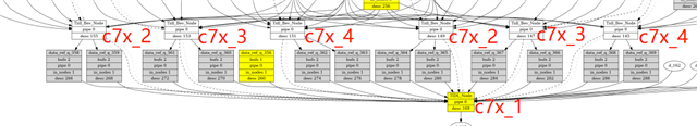

  • This is our onnx model of part1 and part2.
    We generate JPEG visualization of graph through API tivxExportGraphToDot.
    img1:
    img4:
    zhenzhou
  • Hi Zhenzhou,
    From the graph above, you have 3 nodes, tidl_preproc_node, TIDL_Bev_node and TIDL node.
    TIDL node is running on C7x_1 as per the diagram, but the error in the log is from C7x_2. Could you tell me which node is running on the same?
    Also Could you please share the full logs here?
    Nikhil

    [C7x_2 ] 266113.444919 s:  VX_ZONE_ERROR:[tivxMemBufferMap:342] tivxMemBufferMap failed (either pointer is NULL or size is 0)
    [C7x_2 ] 266113.446608 s:  VX_ZONE_ERROR:[tivxMemBufferMap:342] tivxMemBufferMap failed (either pointer is NULL or size is 0)
    266113.455196 s:  VX_ZONE_INFO:[ownDataRefQueueDequeueDoneRef:153] DQ (queue=235, ref=7)
    [C7x_2 ] 266113.448311 s:  VX_ZONE_ERROR:[tivxMemBufferMap:342] tivxMemBufferMap failed (either pointer is NULL or size is 0)
    [C7x_2 ] 266113.450032 s:  VX_ZONE_ERROR:[tivxMemBufferMap:342] tivxMemBufferMap failed (either pointer is NULL or size is 0)
    266113.458191 s:  VX_ZONE_INFO:[ownDataRefQueueEnqueueReadyRef:89] Q (queue=258, ref=16)
    266113.458228 s:  VX_ZONE_INFO:[ownDataRefQueueEnqueueReadyRef:114] Re-triggering (node=145)
    [C7x_2 ] 266113.451723 s:  VX_ZONE_ERROR:[tivxMemBufferMap:342] tivxMemBufferMap failed (either pointer is NULL or size is 0)
    [C7x_2 ] 266113.453409 s:  VX_ZONE_ERROR:[tivxMemBufferMap:342] tivxMemBufferMap failed (either pointer is NULL or size is 0)

    above is full logs.  below is nodes running on the cores
    zhenzhou
  • Hi zhenzhou,
    Is it possible to share the source code for your application here?
    I would like review how you have configured the batch processing part here and selected only C7x_2,3 and 4 for the same
    Nikhil
