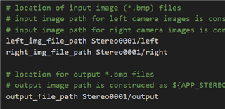

Hi Brijesh,
I mean if a pixel in sde result is in coordinate (x,y), does this mean that the corresponding pixel locates in (x, y) in left image or in (x, y) in right image?
Adam
Hi Adam,
The disparity output from SDE in terms of x and y is always with the reference one image and onto the second image. so one input image is reference and second image is where pixel is searched.
Brijesh
Hi Brijesh,
I see. Thanks for clarification. But which is the reference one image? the left one or the right one? The config of stereo demo only defines left and right path:
Adam
Hi Adam,
I dont recollect what is the reference image, can you please check it in the SDE specs?
