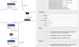

TDA4VM: Model compilation error
Part Number: TDA4VM
there are error occurred when compiling the model by edgeai-idle-tools。
device :TDA4VM
Error log:

Unsupported (TIDL check) TIDL layer type ---   ConvTranspose
Supported TIDL layer type ---            Conv -- /aggregation/fusions.3/fuse_layers.0.1/fuse_layers.0.1.0/Conv
Supported TIDL layer type ---   ConvTranspose -- /aggregation/fusions.3/upsample2x_1/ConvTranspose

Preliminary subgraphs created = 16
Final number of subgraphs created are : 16, - Offloaded Nodes - 534, Total Nodes - 549
WARNING -- [TIDL_ConvolutionLayer]  Layer parameter combination has undergone limited validation and may have some issues. Following are the parameters:
        Kernel 4x4 Stride 2x2 dilation 1x1 Pad 1x1 Bias 1
SUGGESTION -- [TIDL_Deconv2DLayer]  Please change to Upsample/Resize if possible. Upsample/Resize will be more efficient.
