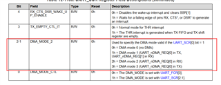

After running, I read the MCU_UART register before UART_write and before UART_close respectively, and found that the bit3 of the registers UART_FCR and bit2 of UART_SCR are 0. According to the description of the TRM document, these two bits are currently no dma. How do I determine whether uart DMA is enabled?

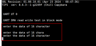

  • Hi, Neehar
    The log after 16 characters is as follows.
    ▒SBL Revision: 01.00.10.01 (Mar 19 2024 - 17:21:51)
    TIFS  ver: 8.6.3--1-g2249f (Chill Capybara
     UART UT 0
     UART DMA read write test in block mode
     enter the data of 16 character
     Data entered is as follows
    asdfghjklqwertyu
    My question is which register should I read to confirm that MCU_UART0 is transmitted using DMA? Or how can I confirm that MCU_UART0 is transmitted using DMA?

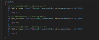

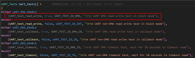

  • Hi,Neehar
    I modified a simple test example based on the sample code to see the value of the dmaMode and found that the value of the dmaMode was indeed 1

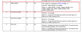

  • HI bingxian,
        As I wrote to you in the e-mail, the register DMA_MDOE  is write only, we can't get it by register read. But we enabled in the  source code UART_open_v1. Please check.
    Linjun
