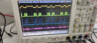

By using the SPI module of TMS320C6678 to simultaneously control two SPI ICs (5-wire system), there is a significant delay of 492 ns between commands during continuous SPI instruction writing What is the reason for the excessive delay in writing SPI data in the SPI register, as both the SPI_SPIFMT.WDELAY and the SPI_SPIDELAY-C2TDELAY are set to 0?
ch1:cs  ch2:clk  ch3:SIMO CH4:SOMI
    The delay is likely coming from the software driver.

  • The delay may be caused by software code, and the CS switch in the oscilloscope generates a 310ns delay. In the code, SPI writing data will determine the SPIBUF-TXFULL bit (while (gpSPIirregs ->SPIBUF&CSL_SPIISPIBUF-TXFULL_MASK), and then write data to gpSPIirregs ->SPIDAT1. The received data will determine the SPIFLG-RXINTFLG bit (while (gpSPIirregs ->SPIBUF&(CSL_SPISISIBUF-RXEMPTY-MASK)) Read gpSPI-regs ->SPIBUF again. The test found that the delay was caused by SPIBUF-TXFULL and SPIBUF-RXEMPTY waiting delays. If the judgments are deleted, these judgments cannot guarantee the correctness of SPI's read and write data.
