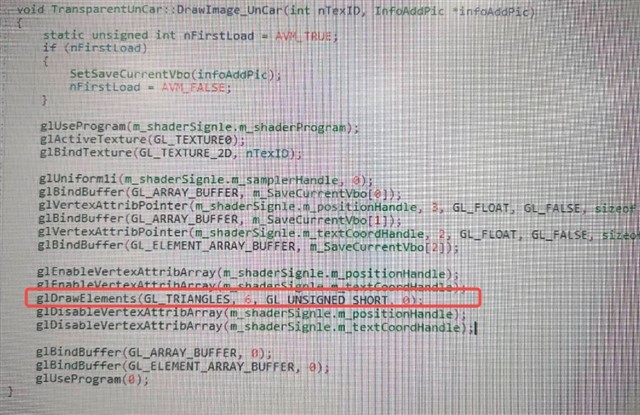

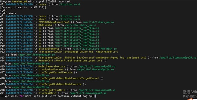

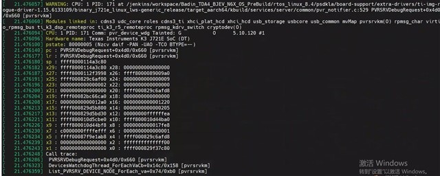

Customer now meet GPU issue. They do pressure test, 30 seconds power on, 10 seconds power off.  Issue reproduce about once every 2000 times.
Scenario is power on, issue happen, there is no display in the screen. After 17 mins, coredump. During this period, there is no display all the time.
When the issue happen, I let them capture pvr log.pvrlogdump_error.txt

Here is the GPU log in terminal.
Here is the function call in their code project:
Here is the core dump log:
Please help to further debug.
