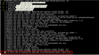

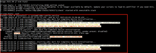

Hi, TI expert:
I'm using ti-processor-sdk-linux-j7-evm-08_06_00_11 with ourselves designed board.
before login, have to wait for 2min57s.
what's wrong?

    I've tried to re-flash rootfs, the problem still exists.
    Since I used our board, i changed the DTS according to our board, then this problem occurred.
    Thanks!

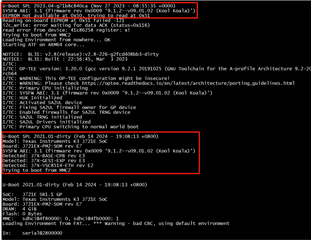

    What is the difference b/n the TI EVM and your board? Is there any difference in the parts used?
    Also, can you share all the changes you made to your board so we can review them?
    Thanks.

    Can you tell what's going on during the 2min57s? Waiting for what to initialize?
    Thanks!

  • Hi,from the log, it's SPL .
    Didn't use any vision_apps.
    Thanks!

  • Hi Keerthy,
     Do you mean 'U-Boot SPL 2021.01-dirty', the magic number problem?
     Can you explain more details about 'by adding vision_appa dtbo along with the dtb file', I have no idea about 'vision_appa dtbo'.
     I'll fix the ''U-Boot SPL 2021.01-dirty' problem, then try again.
    Thanks!
    When fix 'U-Boot SPL 2021.01-dirty' problem, have to wait for 2min57s disappear.
    Best regards!
