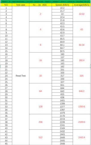

1. Why read speed is just 1/3 as write speed?
Read speed should not be 1/3 of write speed - this is an anomaly. As an experiment, you could try read/write using SSD as an endpoint. This should automatically link to the nvme kernel module instead of the pci endpoint kernel module, and this should give you a better estimate of what read/write performance should be.
We use a PCIe SSD as endpoint, and test the read/write performance. And the test result is as below.
It seems SSD read result is much better than using TDA4VH(about 2.4GB/s) as EP(about 700MB/s).
And SSD write result is a little worse than TDA4VH EP. (1.7GB/s to 1.9GB/s).
And what I want is
1. Your opinion about the test result?
2. What we want to do is enhance READ performance, is there any idea about how to do that?
Thank you.

2. Read performance
