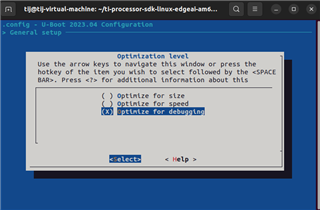

We would like to change the optimiztion level in u-boot for debugging.
But after this change, we faced the make error. Do you know how to fix this?

I have encountered the same error on changing the optimization level on menuconfig.
Could you try adding this option: CONFIG_CC_OPTIMIZE_FOR_DEBUG=y, to am62ax_evm_a53_defconfig and re-build the a53 binaries, and test again.

Hi Aparna,
I couldn't solve issue. I still faced build error.

Hi Ito-san,
What build error do you see?
I have reciprocated the same on my setup and I was able to build and boot successfully.
