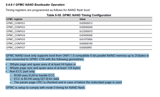

I would like to test GPMC NAND boot with SK-AM62.
Q1. Could you provide me something like a daughter board that can connect GPMC NAND to SK-AM62?
Q2. Does AM62x support following NAND memories?:
- IS34ML02G081
- MT29F2G08ABAEAWP
Koji
Koji

Hello Koji,
Thank you
Please refer to the GPMC nand boot requirements in the TRM.
5.4.9.1 GPMC NAND Bootloader Operation
Sreenivasa
