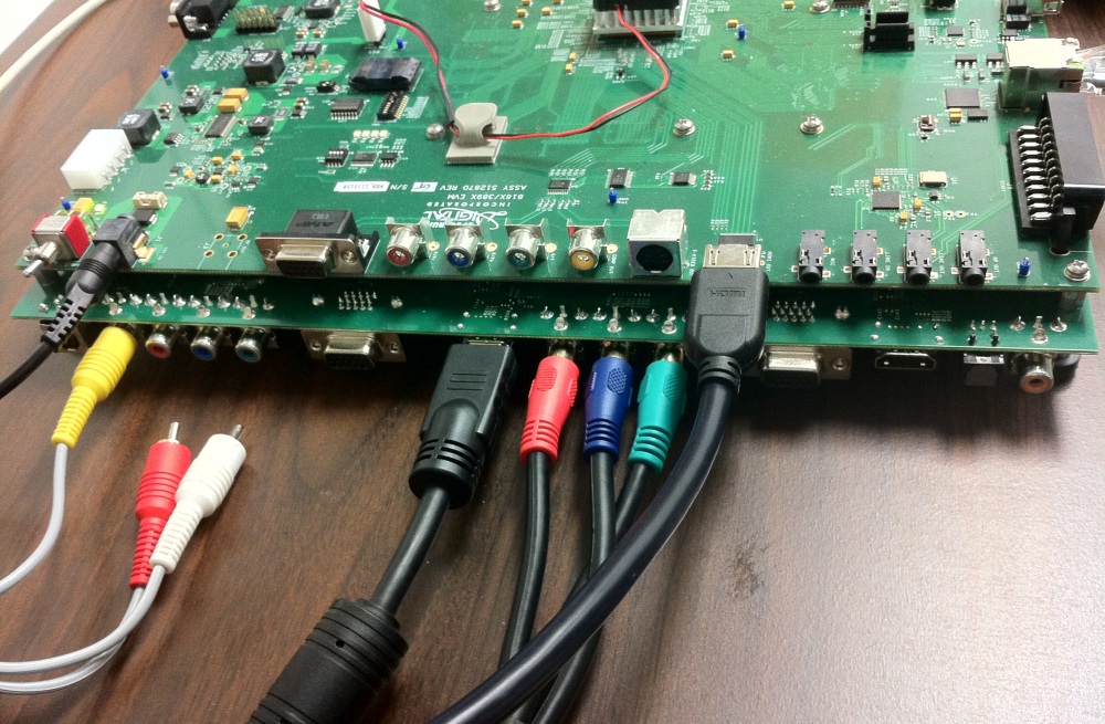

  • Also having trouble getting the various video inputs on the expansion i/o daughter card to work. In fact, even the McFW demo app is not able to 'detect' any video sources.
    Setup ... I've re-targeted the ‘DVRRDK_V03.00.00.00’ at the EVM (using Rules.Make) and can boot (kernel), load the M3 firmware and A8 ko’s and even run the mcfw cmd-line demo (/opt/dvr_rdk/ti816x/bin/dvr_rdk_demo_mcfw_api.out) that works on the DVR-RDK board.
    Output on the command line seems to indicate that everything (M3fw, ko, program) loaded and is running correctly, and the monitor connected to the HDMI-out (not the daughter card) display shows the “Texas Instruments” overlay (i.e. the OSD generated by the C6x DSP) but I can’t seem to access any video inputs that I have connected to D12 (composite input via NTSC camera), HDMI IN2 (DVI video via DVI camera) or [D6, D7, D8] (component in via another 8168x_evm board demo).
    I would assume that I would need to modify a driver of some sort to gain access or 'map' to the correct video inputs (on the EVM). Perhaps someone here can help? Ideally, we are looking at getting the 1xDVI (HDMI_IN2 on the EVM) and 1xNTSC_composite (D12 on the EVM) video inputs working.
    Component input is supported with 1080P60, 720P60 and 1080i60 modes.
