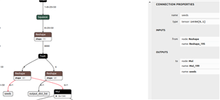

Hello Champs ,
I am trying to run my custom onnx model using edgeai at 9.2 sdk and during compilation mode getting the following error
onnxruntime.capi.onnxruntime_pybind11_state.Fail: [ONNXRuntimeError] : 1 : FAIL : This is an invalid model. Error: Duplicate definition of name (seeds).

  • 1. I was able to run the model in onnx rt and get the required output
    2. i have shared both debug_level2 and 6 of model compilation

  • Hi Abhi,
    "Running runtimes graphviz - /home/abhilash/edgeai-tidl-tools/tidl_tools/tidl_graphVisualiser_runtimes.out /home/abhilash/edgeai-tidl-tools/model artifacts/condlanet_org/condlanet_org//allowedNode.txt /home/abhilash/edgeai-tidl-tools/model artifacts/condlanet_org/condlanet_org//tempDir/graphvizInfo.txt /home/abhilash/edgeai-tidl-tools/model-artifacts/condlanet_org/condlanet_org//tempDir/runtimes_visualization.svg "
    From the above shared logs it seems like model import failed during execution of graph visualizer tool.
    Have you shared the same model "FNC_NewForkV1_July14_epoch80_opset9_sim.onnx" with us ?
    If not i would recommend to share the same (model and workspace delta) with us so we can try to replicate the issue at my end.
    Pratik
  • Hi Pratik
    can we disable the graph visualizer tool to check if other steps are getting processed ? Is there any flag to disable it
    No you donot have that model , i shall share that model with you guys shortly

    Layer 0, subgraph id subgraph_2, name=seeds
    Layer 1, subgraph id subgraph_2, name=454
    Layer 2, subgraph id subgraph_2, name=458
    Layer 3, subgraph id subgraph_2, name=448
    In TIDL_runtimesOptimizeNet: LayerIndex = 7, dataIndex = 4

  • Update :
    As per my discussion with team this seems be issue specific to allowlisting mechanism, as result unsupported layer might have considered as supported during ref kernel inference call, error code -1120 confirms the same.
    As next step i have filed JIRA to track this issue,
