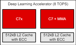

How many tops does C7x without MMA have?
Can AI compiler output model run-time of pure DSP algorithm (without MMA)?

Hi Daniel,
Information about TOPS performance is given in the TDA4AL datasheet here. The combined C7x cores have a total of 512 GOPS.
To clarify, are you asking if there is a way that layers of a imported model using TIDL tools can run solely on the C7x core and not utilize the MMA? Utilizing the MMA for certain layers will achieve better performance.
