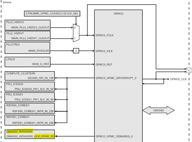

I found that there are 10 GPIO can be routed to DMASS in main domain.
Hello Zekun,
Yes, it is possible with the help of GPIO we can trigger DMA other than NAND memories .
So, your GPIO input is the local event that even needs to be converted to a global event to transfer DMA.
Please look at the images below for more details.
Also in the GPMC module, I found there is also DMASS can be accessed.
Actually, GPMC_SDMAREQ is a local event. It is generated from the GPMC FIFO. When the GPMC FIFO is filled with 64bytes, then this event is triggered and based on this event ,GPMC can trigger DMA transferring data either source to destination memory or vice versa .
So, when GPMC is used the DMA , then this event is needed.
Now, you want to transfer data from NAND memory to destination memory with the help of GPIO.
This is not possible as there is already a local event (GPMC_SDMAREQ) and it is used by GPMC with DMA to transfer data from NAND memory to destination memory or vice versa. So, again, we can't add one more GPIO event to trigger the DMA event.
Now, How can you do?
Configure GPIO interrupt .
When the GPIO interrupt comes , call the DMA start API in the IRQ routine. This is the only way you can do it.
Anil.
