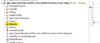

  • Hello Geoffrey,
    May I know where you are creating this .asm file ?
    Is it under the MCU+SDK example ?
    Are you doing similar as below ?
    Anil.
