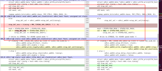

I'm working on custom-designed, TDA4VM-based board. It's highly based off the SK reference design. We're currently migrating our build of processor SDK Linux to 09-02-00-05 which was recently released.
After getting the image, we're unabled to boot linux off emmc. The emmc is visible in uboot and works with older images.
The linux log has the following lines:
[    2.087754] mmc0: mmc_select_hs200 failed, error -110
[    2.092801] mmc0: error -110 whilst initialising MMC card
I bisected the linux kernel and found tthat the following commit is where the emmc stops working:
commit 14951df5ad99fdc639e235aee64d8476189b956c
Author: Judith Mendez <jm@ti.com>
Date:   Thu Feb 15 11:13:19 2024 -0600
    mmc: sdhci_am654: Add missing OTAP/ITAP enable
    Currently the OTAP/ITAP delay enable functionality is missing in
    the am654_set_clock function which is used for MMC0 on AM62p
    and AM64x devices. The OTAP delay is not enabled when timing <
    SDR25 bus speed mode. The ITAP delay is not enabled for all bus
    speed modes.
    Add this OTAP/ITAP delay functionality according to the datasheet
    [1] OTAPDLYENA and ITAPDLYENA for MMC0.
    [1] https://www.ti.com/lit/ds/symlink/am62p.pdf
    Fixes: 8ee5fc0e0b3b ("mmc: sdhci_am654: Update OTAPDLY writes")
    Signed-off-by: Judith Mendez <jm@ti.com>
 drivers/mmc/host/sdhci_am654.c | 38 ++++++++++++++++++++++----------------
 1 file changed, 22 insertions(+), 16 deletions(-)
Please let me know if there's some fix available

      • Older SDK works fine. The bisection indicates an issue was introduced in the kernel between these two versions.
    Once you revert the patch is it start working?  As on our EVM we dont have the same emmc part as of your so can not  reproduce the same issue at our end.
    Can you dump these register as well in both pass and fail case:

  • Hey Diwakar
    Yes it works. I decided to revert these 7 or so related commits from February:  https://git.ti.com/cgit/ti-linux-kernel/ti-linux-kernel/log/drivers/mmc/host/sdhci_am654.c?h=ti-linux-6.1.y
    When I do so, the eMMC comes up in HS200 mode which is the max supported by our chip. This is an effective workaround for us, but we'd always prefer an upstream fix.

  • Hi Paul
    Thanks for sharing the register dump do you know which exact commit is causing the issue is it this one only ?
    if yes i need to check with the developer on this.
    Diwakar
  • Hey Diwakar
    I identified that commit based on a bisection process, which is a binary search for the first commit that introduces the behavior being searched for. I first found an older commit that (1) builds successfully with the rest of the PSDK/Yocto setup and (2) allows the eMMC to work. That commit was designated as "Good". Then I designated the current commit specified in the kernel recipe as "Bad". Git will then optimally search for the first commit that introduces bad behavior. At each stage, I built the kernel, deployed it to the board, rebooted and tested the eMMC (check kernel logs, look for it in /dev). I deployed to and boot off of the SD Card, so I could boot regardless of whether the bug was present in the current commit or not, since this bug doesn't affect our SD Card.
    In summary, here is what I know regarding commits and eMMC behavior:
    • The bisection took place on the `ti-linux-6.1-.y` branch
    • The commit (2e423244f8c09173a344e7069f0fe2bdf26cccee)
      pointed-to by the kernel recipe has the broken eMMC behavior.
    • The initial bug-free commit was (31c70a855d7109f70fb431c64d3d00dead). This was the chosen starting point because anything older wouldn't build because of something related to changes to ti_arm64_prune.config. In any case, it was a good starting point because it wasn't too far into the past, it could build, and didn't contain the bug.
    • Git lets you bisect just a directory, so I only tested commits that changed files in `/drivers/mmc`
    • The commit I mentioned earlier (14951df5ad99fdc639e235aee64d8476189b956c) is the first commit where the eMMC stops working.
    • I don't remember the exact sequence that the bisection went through. Aside from the starting points and the final identified commit, I don't remember which commits were tested. This bisection process took more than a day and I don't want to repeat it. However, it's probably safe to say that in addition to the starting points and end point, several commits before and after the one that introduced the bug were tested and had consistent behavior (i.e. good before the identified commit, bad after the identified commit), otherwise the results of the bisection would have been different.

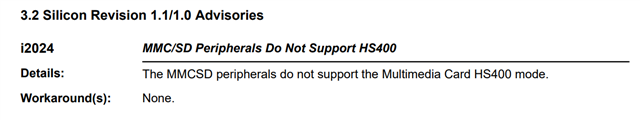

  • Hi Paul
    What is the silicon revision you are using ?
    on 1.0 and 1.1 we had a errata where HS400 does not work.
    https://www.ti.com/lit/er/sprz455d/sprz455d.pdf?ts=1715054247872&ref_url=https%253A%252F%252Fwww.google.com%252F
    Diwakar
  • I'm on 1.1 it seems. However, my eMMC isn't capable of HS400, so I'm not sure this erratum would apply to me.

  • Hi Paul
    Have you checked the wave form is there any major difference you are seeing after 8.2 mmc patches.
    The errata is specific to SOC though your device doesnt support HS400 so it will not effect you.

  • I don't have a scope, so I can't check. I can see if our hardware people have time to do a test, but I don't know when that will happen.
    As I mentioned earlier, reverting this batch of commits is a satisfactory workaround for us. So I'm okay resolving this thread for now. If your development team is interested in investigating this further, I'm happy to try out any patches, but we don't have EE lab equipment at my location, so I'm limited to testing from a software perspective.
