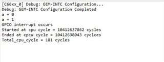

  • Hi Shankari G,
    PFA for the same.
    Warmest regards,
    Krishn Sigh Chauhan
    Very Good progress....
    Now try with the matrix keypad and check whether the interrupt occurs in GPIO.
    I mean now, trigger the GPIO interrupt externally using your matrix keypad by just modifying the same code.
    Shankari G
    Thanks for your support.
