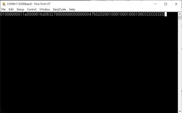

Hi Expert
Customer said that the circuit is based on the BeaglePlay without any changes, but it cannot boot.
There are six boards with the same situation.
Do you have any suggestions on how to debug?
SOC:AM6254ATCGGAALW

Hi Daniel,
Thanks for your question.
So what are you seeing is the initial logs on the UART console and I am assuming these logs came while your board is in UART boot mode.
This is quite expected in terms of what is being printed on your terminal, it can be verified from this link: https://software-dl.ti.com/mcu-plus-sdk/esd/AM62X/latest/exports/docs/api_guide_am62x/EVM_SETUP_PAGE.html#EVM_FLASH_SOC_INIT
I think after this you can follow the steps mentioned at https://docs.beagleboard.org/latest/intro/support/getting-started.html#download-the-latest-software-image
