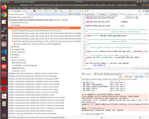

Hello TI,

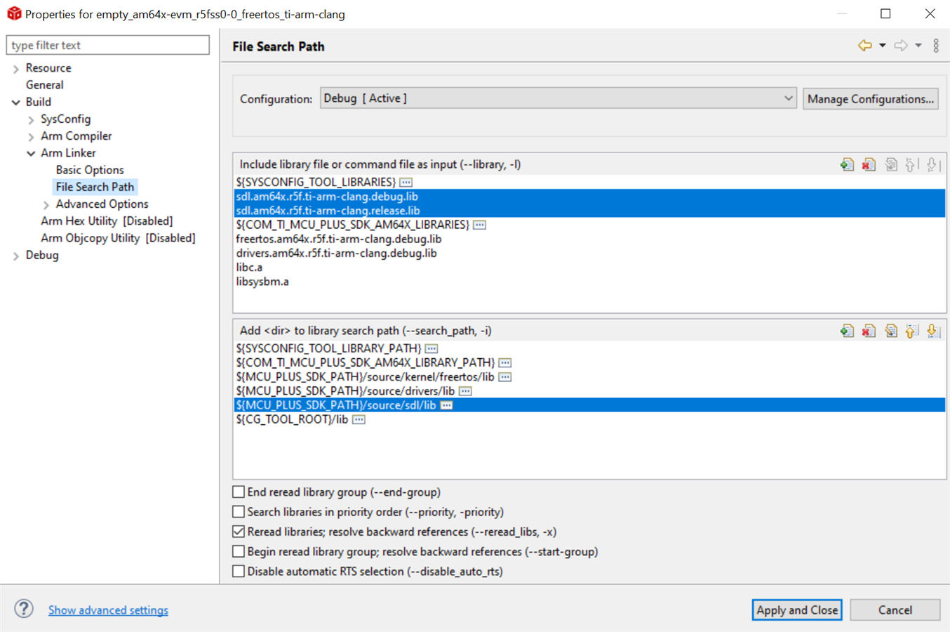

I am using Mcu+sdk v 09.01.00 and imported r50-0 freeRTOS empty project into CCS,And i have done some modification to that example which can capable to work as a mcrc in Software diagnostics library.
But while compiling i am getting error which i mentioned bleow,

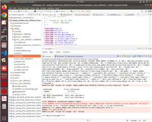

makefile:148: recipe for target 'empty_am64x-evm_r5fss0-0_freertos_ti-arm-clang.out' failed
undefined first referenced
symbol in file
SDL_MCRC_channelReset ./mcrc_uesr_defined.o
SDL_MCRC_init ./mcrc_uesr_defined.o
error #10234-D: unresolved symbols remain
error #10010: errors encountered during linking; "empty_am64x-evm_r5fss0-0_freertos_ti-arm-clang.out" not built
tiarmclang: error: tiarmlnk command failed with exit code 1 (use -v to see invocation)
gmake[1]: *** [empty_am64x-evm_r5fss0-0_freertos_ti-arm-clang.out] Error 1
gmake: *** [all] Error 2
makefile:144: recipe for target 'all' failed
i have included the mcrc_sdl.h header file why i am getting this error?
