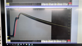

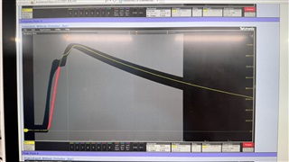

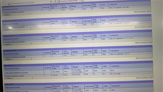

While compliant testing for 1000Base-T at the ethernet port of SK-TDA4VM, I observed two failure result at Mask test templateH/F.
set : @tda4vm-sk:/opt/edgeai-gst-apps# phytool write eth0/0/0x9 0x3B00
enabled mode1 at lane 1 and observed lane 1

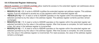

root@tda4vm-sk:/opt/edgeai-gst-apps# phytool write eth0/0/0x25 0x480

Is there any debugging point for this? for example, setting change of VoD,, and so on.
You can't change the VoD supplied to PHY. It is fixed
Can I enable mode 1 to 2,3,4 lane?
With this cmd, I could not see any singals on 2,3,4 lane.
The way you are accessing is wrong.
0x25 is falls under Extended registers set. you have to access using the REGCR (0x000D) and ADDAR (0x000E) register. Please refer to Data sheet for more information.
Also, if you have any queries related to PHY, please create new thread with PHY title not with TDA device name.
Thread will be assigned to PHY Team and they will address PHY related queries.
