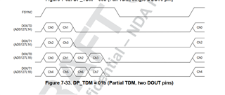

We are using the ADC as an SPI master and we would like to use McSPI1 and McSPI3 as slave controllers, that in an R5F0 application. The idea is to configure the UDMA in a way, that we basically implement endless circular reading, i.e.
- The ADC is configured for delivering 32-bit data frame, using 2 DPORTS (Ch0-3 on D0, CH4-7 on D1). The sample rate is configured to 128 KSPS, which results in 32,7 MHz data clock
- The DMA is provided with a buffer in MSRAM, which is 16KB (for example)
- The DMA is configured in a way, that it delivers an interrupt for each 32 packets read (32xFSYNC), altogether 512 bytes (4ch x 4 bytes x 32 frames)
- After delivering the interrupt, the DMA continues with the next 32 packets and the target offset in the memory is incremented with 512 bytes
- The process continues, until the buffer end is reached, then the DMA should start from the initial buffer offset

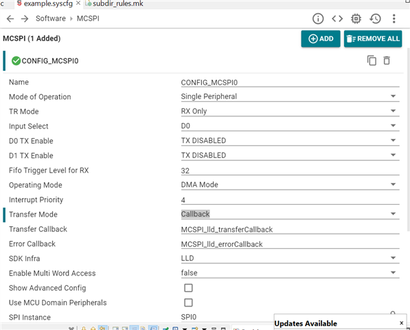

    C:\ti\mcu_plus_sdk_am64x_09_02_00_50\examples\drivers\mcspi\mcspi_loopback_dma_lld\am64x-evm
    You need to set the parameters below for Peripheral mode . The same example can be used for your requirement .
    Just you need to update the DMA length and one more thing I have noticed that in Peripheral mode DMA call back is not registering .
    So, we need to register DMA callback as well. Can you please use the above attached  example  and will  try to fix other issues while you are working on your example  ?

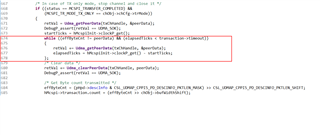

    I already tried that mode (Peripheral+DMA). There were two problems:
    1. The code always got stuck in the DMA interrupt routine in MCSPI_udmaIsrTx in mcspi_dma_udma.c here:
    The reason is, that peerData  was always exactly 304 bytes bigger than effByteCnt, the expected byte count. The data reception was initiated with

    2. The DMA interrupt performs a Tear Down of the DMA channel, when the transfer is ready and this channel needs to be reloaded then again with the above call. According to TI's own papers, it takes at least 7us to do that. We don't have that time, as we get samples each 8us, so from the end of a DMA transfer until the begin of the next one we only have maximum 8us in theory, in reality about 4us.

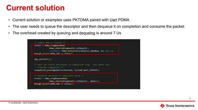

    My suggestion is that we can try to stick with the MCSPI+PKTDMA and don't go with BCDMA since, as you mentioned, UDMA chapter is difficult and will take more time to solve the issues if we get during implementation and don't have  an examples .
    I understand your concern, so if you look at the driver dma_write/dma_read api, it's typically a combination of channel initiizations and then start DMA for each channel. After completion of DMA channels we are closing the channels.Again, when you need to start DMA again we, are initilizting the channels and starting the DMA. Here, you can notice every time why we need to initialize the channels in your case.
    So, we can skip the teardown and initializations of channels in the driver for every each DMA start and completion respectively . And, for DMA, start and completion are typically done with the udma_queraw and udma_dequeraw functions, which are typically controlling DMA registers and do not take that much time.
    Conclusion  , we will use the udma_queraw and udma_dequeraw functions for every DMA start and completion and will initialize the DMA channels for only one time.

    First of all, I don't find those functions that you mentioned. I only found Udma_ringQueueRaw and Udma_ringDequeueRaw.  However, rhe latter is commented with:
     *  Caution: Dequeuing from a ring (free queue) to which the UDMA reads
     *  should be performed only when the channel is disabled and using
     *  #Udma_ringFlushRaw API.
    That could be a problem or not, I don't know at the moment.
    Frankly speaking I really have a bad feeling for the solution you propose, since it involves interrupt handling and as I mentioned, we have only 2-3 us to react, meaning: DMA generates the completion interrupt request, the interrupt getting propagated to the core, the interrupt routine being executed and the dma descriptor enqueued. Normally, 3 us is a lot of time @ 800Mhz, unfortunately we are running a lot of other tasks in on this CPU and I cannot guarantee, that the dma interrupt will never be blocked either from another high-prio interrupt or from the FreeRTOS. Moreover, we have 2 SPI interfaces, meaning 2 interrupts to be handled.
    What I could imagine, is queuing more than one descriptor and get an interrupt on each descriptor's completion. This way the interrupt reaction time is not critical, as the DMA continues with the next descriptor. Unfortunately, from what I read, I don't see a possibility for PKTDMA to generate events on a descriptor's completion, but only on the complete queue. I hope I understood it wrong, but that could be done only trough BCDMA.
    Anyway, we can try to solve the problem the way you suggested, but I would be needing a guide how to exactly do that, as an example code, in the best case.

  • Frankly speaking I really have a bad feeling for the solution you propose, since it involves interrupt handling and as I mentioned, we have only 2-3 us to react, meaning: DMA generates the completion interrupt request, the interrupt getting propagated to the core, the interrupt routine being executed and the dma descriptor enqueued. Normally, 3 us is a lot of time @ 800Mhz, unfortunately we are running a lot of other tasks in on this CPU and I cannot guarantee, that the dma interrupt will never be blocked either from another high-prio interrupt or from the FreeRTOS. Moreover, we have 2 SPI interfaces, meaning 2 interrupts to be handled.
    Hello Angel,
    Yes, I agree with your point. The problem with PKTDMA is not reloading possible. So, every time we need to start the DMA for every transaction.
    I am trying to stick with MCU+SDK examples with some modifications in the driver. If we go for MCSPI+BCDMA then any issues comes it will take more time to fix these issues.
    I assume that packet descriptor linking is possible. But here we may skip the queraw and dequeraw functionality for every packet descriptor, but we need to do queuing and dequeuing for every 2 second packet.
    I can check with other team members if there is any possibility to reload the packet infinite times in PKTDMA . So, that no need to start DMA for every each transaction.
    As of now, I have just split two functionalities, one for Channel initializations and another for DMA start.
    And after completion of DMA, I have not teardown the channels since we skipped channel initializations every time.
    I agree with your point querraw and dequearaw functions consume more time.

    Thanks for the detailed explanation above, but I am not really sure how to interpret it. I think you are reading the wrong ADC's datasheet. We use this one:
    https://www.ti.com/product/de-de/ADS127L18
    In this case there is no DRDY, and the ADC plays the SPI master (or Controller), by setting the FSYNC (CS) and clocking the data out trough D0 and D1
    Can you confirm?

  • Hello Angel,
    You are correct . Your ADC does not have a DRDY signal.
    Recently, some other users using different ADCs with the DRDY signal. So, I suggest the same method with the DRDY signal.
    Please don't consider above point if your ADC does not have the DRDY signal.

    * Problem 2: Now we have the PKTDMA servicing the ring with (here) 16 HPDs, and delivering a UDMA_EVENT_TYPE_DMA_COMPLETION event for each HPD processed. The clue: the original ISR (MCSPI_udmaIsrRx in McSPI_dma_udma.c) will be called only once, after which it disables the McSPI and the DMA channel. That is of no use for us, we want to be able to get the HPD processed, save the data (or the pointer to its taget buffer) and push it back to the ring to avoid PKTDMA HPD starvation.
    * Solution: unfortunately, I had to patch the above file, comment out the above ISR handler and declare it as "external". Then, I moved the definition to my own class and did the following modifications:

    1) Leave the McSPI in polling mode in the SysConfig
    2) Make an own wrapper for the combination of McSPI and UDMA channel
    3) Manually open and configure the channel, the event handler in particular
    4) Manually reconfigure the McSPI to use DMA notifications (DMAR/DMAW bits)
