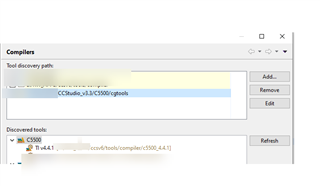

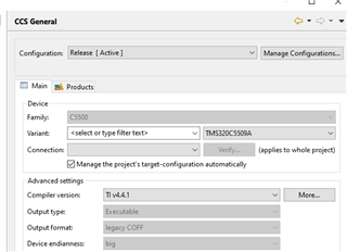

  • Hi Ming,
    Having same errors not sure why getting errors when you dont see it on the C55x compiler. I'm using C55x Compiler version Ti V3.3.2.
  • Hi Ramesh,
    I was using the C55x CGT 4.4.1. I tested it with the SPRC133 C5509 example. It works too. Can you change to the CGT 4.4.1 and try again?
    Ming
  • I changed the C5500_4.4.1 compiler (ccsv6/tools/compiler/c5500_4.4.1/bin/cl55) and I'm seeing same error. Eventually I have to use CCS 3.3.2 as my project is a legacy one should use Compiler 3.3.2
