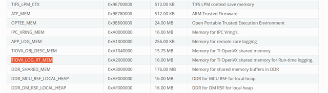

Later I modified the AM62Ax SDK for 1 GB DDR and updated the reserved memory regions as shown below.
|          Memory Section                 |     Physical Address     |   Size   |
| C7x Pool                                      | 0x99800000                 | 1MB    |
+---------------------+---------------+-----+ | C7x Pool | 0x99900000 | 31MB |
+---------------------+---------------+-----+ | R5F(mcu) Pool | 0x9b800000 | 1MB |
+---------------------+---------------+-----+ | R5F(mcu) Pool | 0x9b900000 | 15MB |
+---------------------+---------------+-----+ | R5F(wkup) Pool | 0x9c800000 | 1MB |
+---------------------+---------------+-----+ | R5F(wkup) Pool | 0x9c900000 | 30MB |
+---------------------+---------------+-----+ | edgeai rtos ipc memory region | 0xa0000000 | 16MB |
+---------------------+---------------+-----+ | edgeai memory region | 0xa1000000 | 32MB |
+---------------------+---------------+-----+ | edgeai shared region | 0xa3000000 | 176MB |
+---------------------+---------------+-----+ | edgeai core heap | 0xae900000 | 32MB |
+---------------------+---------------+------+ | linux,cma | 0xb0000000 | 256MB |
We need to boot the board in Ethernet boot mode. After modyfing the memory regions, the object detection demo application camera streaming with Ethernet does not work.
Is it because of the reduced memory for the "edgeai core heap" area in the reserved memory?
Could you please help to debug on how to assign the reserved memory areas for the EdgeAI appication regions.

  • Hi Reese,
    I have rebuilt the firmware and can boot the am62ax board with the below memory map
    Partition Start Address Size
    DDR_C7x_1_IPC 0x99800000 1024.00 KB
    DDR_C7x_1_RESOURCE_TABLE 0x99900000 1024.00 B
    DDR_C7X_1_IPC_TRACEBUF 0x99900400 1023.00 KB
    DDR_C7x_1_BOOT 0x99A00000 1024.00 B
    DDR_C7x_1_VECS 0x99C00000 16.00 KB
    DDR_C7x_1 0x99C10000 15.94 MB
    DDR_MCU_R5F_IPC 0x9AC00000 1024.00 KB
    DDR_MCU_R5F_RESOURCE_TABLE 0x9AD00000 1024.00 B
    DDR_MCU_R5F_IPC_TRACEBUF 0x9AD00400 1023.00 KB
    DDR_MCU_R5F 0x9AE00000 10.00 MB
    DDR_DM_R5F_IPC 0x9B800000 1024.00 KB
    DDR_DM_R5F_RESOURCE_TABLE 0x9B900000 1024 B
    DDR_DM_R5F_IPC_TRACEBUF 0x9B900400 1023.00 KB
    DDR_DM_R5F 0x9BA00000 13.00 MB
    TIFS_LPM_CTX 0x9C700000 512.00 KB
    ATF_MEM 0x9C780000 512.00 KB
    OPTEE_MEM 0x9C800000 24.00 MB
    IPC_VRING_MEM 0x9E000000 16.00 MB
    APP_LOG_MEM 0x9F000000 256.00 KB
    TIOVX_OBJ_DESC_MEM 0x9F040000 15.75 MB
    TIOVX_LOG_RT_MEM 0xA0000000 16.00 MB
    DDR_SHARED_MEM 0xA1000000 64.00 MB
    DDR_MCU_R5F_LOCAL_HEAP 0xA5000000 16.00 MB
    DDR_DM_R5F_LOCAL_HEAP 0xA6000000 16.00 MB
    DDR_C7X_1_LOCAL_HEAP_NON_CACHEABLE 0xA7000000 16.00 MB
    DDR_C7X_1_SCRATCH_NON_CACHEABLE 0xA8000000 16.00 MB
    DDR_C7X_1_LOCAL_HEAP 0xA9000000 64.00 MB
    DDR_C7X_1_SCRATCH 0xAD000000 48.00 MB
    But while running the demo application I observed the below error:

    I have not used the address 0xa2000000 in the updated memory map table and am confused about whether I have missed any other files that need to be taken care of while doing the firmware builder.
    I would have expected the memory regions it's allocating to have shown as starting from the TIOVX_LOG_RT_MEM base, so there may have been a missed step here.
    After you updated the memory maps and linker files, I see you updated the C7x firmware. Did you do the equivalent for the DM R5 firmware? This would have required the bootloader be updated with the resulting binary from rebuilding DM R5 firmware.
    Could you also attach a log printed from running /opt/vx_app_app_remote_log.out?

    [    0.000000] Booting Linux on physical CPU 0x0000000000 [0x410fd034]
    [    0.000000] Linux version 6.1.46-00013-g782b18c7ca1f-dirty (ann@LAP872U) (aarch64-none-linux-gnu-gcc (Arm GNU Toolchain 11.3.Rel1) 11.3.1 20220712, GNU ld (Arm GNU Toolchain 11.3.Rel1) 2.38.20220708) #2 SMP PREEMPT Mon Jun 17 17:52:51 IST 2024
    [    0.000000] Machine model: Texas Instruments AM62A7 SK
    [    0.000000] earlycon: ns16550a0 at MMIO32 0x0000000002800000 (options '')
    [    0.000000] printk: bootconsole [ns16550a0] enabled
    [    0.000000] efi: UEFI not found.
    [    0.000000] Reserved memory: created CMA memory pool at 0x00000000b0000000, size 256 MiB
    [    0.000000] OF: reserved mem: initialized node linux,cma, compatible id shared-dma-pool
    [    0.000000] Reserved memory: created DMA memory pool at 0x0000000099800000, size 1 MiB
    [    0.000000] OF: reserved mem: initialized node c7x-dma-memory@99800000, compatible id shared-dma-pool
    [    0.000000] Reserved memory: created DMA memory pool at 0x0000000099900000, size 19 MiB
    [    0.000000] OF: reserved mem: initialized node c7x-memory@99900000, compatible id shared-dma-pool
    [    0.000000] Reserved memory: created DMA memory pool at 0x000000009ac00000, size 1 MiB
    [    0.000000] OF: reserved mem: initialized node r5f-dma-memory@9ac00000, compatible id shared-dma-pool
    [    0.000000] Reserved memory: created DMA memory pool at 0x000000009ad00000, size 11 MiB
    [    0.000000] OF: reserved mem: initialized node r5f-dma-memory@9ad00000, compatible id shared-dma-pool
    [    0.000000] Reserved memory: created DMA memory pool at 0x000000009b800000, size 1 MiB
    [    0.000000] OF: reserved mem: initialized node r5f-dma-memory@9b800000, compatible id shared-dma-pool
    [    0.000000] Reserved memory: created DMA memory pool at 0x000000009b900000, size 14 MiB
    [    0.000000] OF: reserved mem: initialized node r5f-dma-memory@9b900000, compatible id shared-dma-pool
    [    0.000000] Reserved memory: created DMA memory pool at 0x000000009f000000, size 32 MiB
    [    0.000000] OF: reserved mem: initialized node edgeai-dma-memory@9f000000, compatible id shared-dma-pool
    [    0.000000] OF: reserved mem: initialized node edgeai_shared-memories, compatible id dma-heap-carveout
    [    0.000000] Reserved memory: created DMA memory pool at 0x00000000a5000000, size 176 MiB
    [    0.000000] OF: reserved mem: initialized node edgeai-core-heap-memory@a5000000, compatible id shared-dma-pool
    [    0.000000] NUMA: No NUMA configuration found
    [    0.000000] NUMA: Faking a node at [mem 0x0000000080000000-0x00000008ffffffff]
    [    0.000000] NUMA: NODE_DATA [mem 0x8ff842a00-0x8ff844fff]
    [    0.000000] Zone ranges:
    [    0.000000]   DMA      [mem 0x0000000080000000-0x00000000ffffffff]
    [    0.000000]   DMA32    empty
    [    0.000000]   Normal   [mem 0x0000000100000000-0x00000008ffffffff]
    [    0.000000] Movable zone start for each node
    [    0.000000] Early memory node ranges
    [    0.000000]   node   0: [mem 0x0000000080000000-0x00000000997fffff]
    [    0.000000]   node   0: [mem 0x0000000099800000-0x000000009c6fffff]
    [    0.000000]   node   0: [mem 0x000000009c700000-0x000000009c77ffff]
    [    0.000000]   node   0: [mem 0x000000009c780000-0x000000009ccfffff]
    [    0.000000]   node   0: [mem 0x000000009cd00000-0x000000009dffffff]
    [    0.000000]   node   0: [mem 0x000000009e000000-0x00000000a0ffffff]
    [    0.000000]   node   0: [mem 0x00000000a1000000-0x00000000a4ffffff]
    [    0.000000]   node   0: [mem 0x00000000a5000000-0x00000000afffffff]
    [    0.000000]   node   0: [mem 0x00000000b0000000-0x00000000ffffffff]
    [    0.000000]   node   0: [mem 0x0000000880000000-0x00000008ffffffff]
    [    0.000000] Initmem setup node 0 [mem 0x0000000080000000-0x00000008ffffffff]
    [    0.000000] psci: probing for conduit method from DT.
    [    0.000000] psci: PSCIv1.1 detected in firmware.
    [    0.000000] psci: Using standard PSCI v0.2 function IDs
    [    0.000000] psci: Trusted OS migration not required
    [    0.000000] psci: SMC Calling Convention v1.2
    [    0.000000] percpu: Embedded 20 pages/cpu s44968 r8192 d28760 u81920
    [    0.000000] Detected VIPT I-cache on CPU0
    [    0.000000] CPU features: detected: GIC system register CPU interface
    [    0.000000] CPU features: detected: ARM erratum 845719
    [    0.000000] alternatives: applying boot alternatives
    [    0.000000] Fallback order for Node 0: 0
    [    0.000000] Built 1 zonelists, mobility grouping on.  Total pages: 1032192
    [    0.000000] Policy zone: Normal
    [    0.000000] Kernel command line: console=ttyS2,115200n8 earlycon=ns16550a,mmio32,0x02800000 mtdparts=fc40000.spi.0:512k(ospi_nor.tiboot3),2m(ospi_nor.tispl),4m(ospi_nor.u-boot),256k(ospi_nor.env),256k(ospi_nor.env.backup),256k(ospi.phypattern);spi-nand0:512k(ospi_nand.tiboot3),2m(ospi_nand.tispl),4m(ospi_nand.u-boot),256k(ospi_nand.env),256k(ospi_nand.dtb),256k(ospi_nand.dtbo),98048k@32m(ospi_nand.rootfs),256k@130816k(ospi_nand.phypattern) root=PARTUUID=0b75d9c4-02 rw rootfstype=ext4 rootwait
    [    0.000000] Dentry cache hash table entries: 524288 (order: 10, 4194304 bytes, linear)
    [    0.000000] Inode-cache hash table entries: 262144 (order: 9, 2097152 bytes, linear)
    [    0.000000] mem auto-init: stack:off, heap alloc:off, heap free:off
    [    0.000000] software IO TLB: area num 4.
    [    0.000000] software IO TLB: mapped [mem 0x00000000fbfff000-0x00000000fffff000] (64MB)
    [    0.000000] Memory: 3399052K/4194304K available (16384K kernel code, 3768K rwdata, 9584K rodata, 7616K init, 616K bss, 533108K reserved, 262144K cma-reserved)

    APP_LOG: ERROR: Unable to map memory @ 0xa1000000 of size 262144 bytes !!!
    APP_LOG: ERROR: Unable to map memory @ 0xa2000000 of size 3288576 bytes !!!
    ^C
    root@am62axx-evm:/opt/edgeai-gst-apps#
    The file named /opt/vx_app_app_remote_log.out is not available instead we have the file /opt/vx_app_arm_remote_log.out
    Also observed the error while running the command /opt/vx_app_arm_remote_log.out
    root@am62axx-evm:/opt/edgeai-gst-apps# /opt/vx_app_arm_remote_log.out
    Please have a look and let me know if any more changes are required.
  • Hi Ann,
    My apologies, I made a typo in the previous message.
    So seems that OpenVX isn't able to start up. I also see references in the boot logs (TY for including these, very helpful) that mention that the remote cores had issues starting up, which is certainly due to this memory mapping issue.
    I see that the some of the early log messages that show memory address ranges are different from the standard EVM boot logs, so at least part of this process has been detected.
    Would you please share the modified python script and resulting linker files from the previous steps? It looks rasonable from what Linux prints, so I'd like to look more into what the remote cores are configured for
    BR,
    Reese
  • HI Reese,
    Sure.
    Attaching the modified python script which has been renamed to a text file since I am facing an issue while uploading the Python file.

    # Shared memory memory sections in DDR
    app_log_mem            = MemSection("APP_LOG_MEM"        , "", app_log_mem_addr       , app_log_mem_size       , "Memory for remote core logging");
    tiovx_obj_desc_mem     = MemSection("TIOVX_OBJ_DESC_MEM" , "", tiovx_obj_desc_mem_addr, tiovx_obj_desc_mem_size, "Memory for TI OpenVX shared memory. MUST be non-cached or cache-coherent");
    app_fileio_mem        = MemSection("APP_FILEIO_MEM"        , "", app_fileio_mem_addr       , app_fileio_mem_size       , "Memory for remote core file operations");
    tiovx_log_rt_mem     = MemSection("TIOVX_LOG_RT_MEM" , "", tiovx_log_rt_mem_addr, tiovx_log_rt_mem_size, "Memory for TI OpenVX shared memory for Run-time logging. MUST be non-cached or cache-coherent");
    ipc_vring_mem      = MemSection("IPC_VRING_MEM"     , "", ipc_vring_mem_addr     , ipc_vring_mem_size     , "Memory for IPC Vring's. MUST be non-cached or cache-coherent");
    ipc_vring_mem.setDtsName("edgeai_rtos_ipc_memory_region", "edgeai-rtos-ipc-memory-region");
    ipc_vring_mem.setAlignment(True)
    ipc_vring_mem.setPrintCompatibility(False)
    ipc_vring_mem.setOriginTag(False);
    edgeai_ddr_total  = MemSection("DDR_EDGEAI_DTS", "", 0                      , 0                      , "DDR for EdgeAI for all sections, used for reserving memory in DTS file");
    edgeai_ddr_total.concat(app_log_mem);
    edgeai_ddr_total.concat(tiovx_obj_desc_mem);
    edgeai_ddr_total.concat(app_fileio_mem);
    edgeai_ddr_total.concat(tiovx_log_rt_mem);
    edgeai_ddr_total.setDtsName("edgeai_memory_region", "edgeai-dma-memory");

    html_mmap.addMemSection( tifs_lpm_mem      );
    html_mmap.addMemSection( atf_mem      );
    html_mmap.addMemSection( optee_mem      );
    html_mmap.addMemSection( app_log_mem        );
    html_mmap.addMemSection( tiovx_obj_desc_mem );
    html_mmap.addMemSection( app_fileio_mem        );
    html_mmap.addMemSection( ipc_vring_mem      );
    html_mmap.addMemSection( ddr_shared_mem     );
    html_mmap.addMemSection( tiovx_log_rt_mem );

  • Hi Reese,
    I have updated the R5 firmware after doing the "make sdk" command and build the u-boot and updated the tispl and u-boot.img file in the sd card.
    I have cross-verified in the firmware builder after issuing the memory-map generation scripts no R5 u-boot dts file related changes are generated. Still, I updated the reserved memory regions in the R5 dts files and ran the "make u-boot" command. It generated the tiboot3.bin, tispl.bin and u-boot.img. Copied and booted the board. The same issue persists.
    Thanks and Regards,

  • Hi Ann,
    It's clear that some of the changes took on the A53 side given dmesg logs. Unsure about the remote core side. I'm looking for other ways to debug what the R5 is seeing. One option is to modify a few lines in the R5 code to set more logging messages (debug zones); see tiovx/source/platform/psdk_j7/common/tivx_init.c
    We should also look at the .map files within vision_apps/out/AM62A/$CORENAME/$OS/release/*.out.map. Are the memory regions here consistent with what you expect? e.g. excerpt from R5F .out.map file resulting from 9.0 fw-builder:
    a0000000  g_ipc_vring_mem
    a1000000  g_app_log_shared_mem
    a1040000  g_tiovx_obj_desc_mem
    a2000000  g_app_fileio_shared_mem
    af000000  g_ddr_local_mem
    I do note that in the linker scripts, the carveouts sizes at 0xA0000000 are 4 MiB instead of 16 MiB, as the table you posted earlier would have suggested. This doesn't resolve the fact that it's trying to allocate from the wrong base-address, though.
    BR,
    Reese

    I need some clarifications which are mentioned below:
    I checked on the tiovx/source/platform/psdk_j7/common/tivx_init.c file, which is already having the tivx_set_debug_zone inside the tivxInitLocal function. Is this what you have mentioned by adding the extra prints?
    I did not understand the carveouts size issue that you mentioned. As per the table, the size at 0xA0000000 is 16MB similar to the SDK change.
    I have looked in the *.out.map files in the $CORENAME folders of R5 and C7504. I can map those file values with the memory map values. But for the A53 core, I am not seeing the address values as you have mentioned. Is this an expected output?
    Ann Rose Antony
  • Hi Ann,
    Yes, there are some already set like ERROR and WARNING. You can add more zones like VX_ZONE_INFO, VX_ZONE_INIT, and VX_ZONE_LOG. That will enable further logging messages. It would be worth enabling all 3 of these for the time-being.
    Your table makes sense and looks good. My comment was based on the APP_FILEIO_MEM having a length of 4MiB when I had expected 16 MiB. Actually I think this is a non-issue. My apologies for the confusion. The linker files in the SDK has the same size for these regions as you have, so this is probably not going to cause errors. The APP_LOG_MEM (name in linker file) region is where the difference in memory configurations is first showing errors, and I mixed up a similar name (TIOVX_LOG_RT_MEM).
    I will assume these match the expectations, then.
    Please confirm, but I assume you did the update for app_mem_map.h as well in this process
    Can you also please post your DTS/DTB files? We haven't looked at those yet. The memory sections for A53 may not be shown in the .map files; I estimate it's pulling that information from DTB in LInux

     * AM62A SK: https://www.ti.com/lit/zip/sprr459
     * Copyright (C) 2022 Texas Instruments Incorporated - https://www.ti.com/
    /dts-v1/;
    #include <dt-bindings/leds/common.h>
    #include <dt-bindings/gpio/gpio.h>
    #include <dt-bindings/net/ti-dp83867.h>
    #include "k3-am62a7.dtsi"
    	compatible =  "ti,am62a7-sk", "ti,am62a7";
    	model = "Texas Instruments AM62A7 SK";
    	aliases {
    		serial2 = &main_uart0;
    		mmc0 = &sdhci0;
    		mmc1 = &sdhci1;
    		ethernet0 = &cpsw_port1;
    		spi0 = &ospi0;
    	chosen {
    		stdout-path = "serial2:115200n8";
    	memory@80000000 {
    		device_type = "memory";
    		/* 4G RAM */
    		reg = <0x00000000 0x80000000 0x00000000 0x80000000>,
    		      <0x00000008 0x80000000 0x00000000 0x80000000>;
    	dma_buf_phys {
    		compatible = "ti,dma-buf-phys";
    	reserved-memory {
    		#address-cells = <2>;
    		#size-cells = <2>;
    		ranges;
    		/* global cma region */
    		linux,cma {
    			compatible = "shared-dma-pool";
    			reusable;
    			size = <0x00 0x10000000>;
                            alloc-ranges = <0x00 0xB0000000 0x00 0x10000000>;
    			/*size = <0x00 0x24000000>;
    			alloc-ranges = <0x00 0xc0000000 0x00 0x24000000>;*/
    			linux,cma-default;
    		secure_tfa_ddr: tfa@9c780000 {
    			reg = <0x00 0x9C780000 0x00 0x80000>;
    			alignment = <0x1000>;
    			no-map;
    		secure_ddr: optee@9c800000 {
    			reg = <0x00 0x9C800000 0x00 0x0500000>; /* for OP-TEE */
    			no-map;
    		wkup_r5fss0_core0_dma_memory_region: r5f-dma-memory@9b800000 {
                    reg = <0x00 0x9b800000 0x00 0x00100000>;
                    no-map;
            wkup_r5fss0_core0_memory_region: r5f-dma-memory@9b900000 {
                    reg = <0x00 0x9b900000 0x00 0x00e00000>;
                    no-map;
    	mcu_r5fss0_core0_dma_memory_region: r5f-dma-memory@9ac00000 {
                    reg = <0x00 0x9ac00000 0x00 0x00100000>;
                    no-map;
            mcu_r5fss0_core0_memory_region: r5f-dma-memory@9ad00000 {
                    reg = <0x00 0x9ad00000 0x00 0x00b00000>;
                    no-map;
    		c7x_0_dma_memory_region: c7x-dma-memory@99800000 {
                    reg = <0x00 0x99800000 0x00 0x00100000>;
                    no-map;
            c7x_0_memory_region: c7x-memory@99900000 {
                    reg = <0x00 0x99900000 0x00 0x01300000>;
                    no-map;
            edgeai_rtos_ipc_memory_region: edgeai-rtos-ipc-memory-region {
                    reg = <0x00 0x9e000000 0x00 0x01000000>;
                    no-map;
            edgeai_memory_region: edgeai-dma-memory@9f000000 {
                    reg = <0x00 0x9f000000 0x00 0x02000000>;
                    no-map;
            edgeai_shared_region: edgeai_shared-memories {
                    compatible = "dma-heap-carveout";
                    reg = <0x00 0xa1000000 0x00 0x04000000>;
            edgeai_core_heaps: edgeai-core-heap-memory@a5000000 {
                    reg = <0x00 0xa5000000 0x00 0x0b000000>;
                    no-map;
    /*		wkup_r5fss0_core0_dma_memory_region: r5f-dma-memory@9ac00000 {
    			reg = <0x00 0x9ac00000 0x00 0x100000>;
    			no-map;
    		wkup_r5fss0_core0_memory_region: r5f-dma-memory@9ad00000 {
    			reg = <0x00 0x9ad00000 0x00 0x0600000>;
    			no-map;
    		mcu_r5fss0_core0_dma_memory_region: r5f-dma-memory@9a500000 {
    			reg = <0x00 0x9a500000 0x00 0x100000>;
    			no-map;
    		mcu_r5fss0_core0_memory_region: r5f-dma-memory@9a600000 {
    			reg = <0x00 0x9a600000 0x00 0x0600000>;
    			no-map;
    			reg = <0x00 0x99800000 0x00 0x100000>;
    			no-map;
    			reg = <0x00 0x99900000 0x00 0x7FFFFF>;
    			no-map;
    			reg = <0x00 0x9b900000 0x00 0x01000000>;
    			no-map;
    		edgeai_memory_region: edgeai-dma-memory@9c900000 {
    			reg = <0x00 0x9c900000 0x00 0x01A00000>;
    			no-map;
    			reg = <0x00 0x9e300000 0x00 0x4c00000>;
    		edgeai_core_heaps: edgeai-core-heap-memory@ae000000 {
    			reg = <0x00 0xa2f00000 0x00 0xD100000>;
    			no-map;

    Okay, this DTS looks correct and I can see where it deviates from the original DTS in the SDK.
    Naming conventions are inconsistent across these tools, but I see that the APP_LOG_MEM maps against the "edgeai_memory_region", at least for the base address. There are several other regions that are included here, based on the size of the region. In your case, the allocations throwing errors should be mapped starting from 0x9f000000
    More logging would still be helpful here I think. We may need to add more as well to diagnose what is happening here.
    For starters, let's consider vision_apps/platform/am62a/linux/app_init.c. The Errors in your log (as below) originate from this file.
    APP: ERROR: Log writer init failed !!!
    It's here (Line 150) that the APP_LOG_MEM_ADDR is provided and memory is mapped inside an appLogWrInit call. We can add some prints here to check.
    In typing the above, I realize one thing that we may not have tried yet: replacing the .SO libraries for tiovx and vision_apps. The vision_apps project would consume this app_mem_map.h file. It seems that this APP_LOG_MEM_ADDR is set at compile time and not read from Linux memory regions at runtime, as I originally suspected.
    In addition to recompiling firmware binaries, there should be an .SO file under vision_apps/out/AM62A/A53/LINUX/release/libtivision_apps.so. Have you replaced this library in the linux filesystem? This may have been done automatically if you used some of the 'install'  make targets (linux_fs_install,  I believe) in the firmware builder, it should handle this. However, I am seeing that this step is missing in the instructions.
    Can you please trying updating this libtivision_apps.SO file? You can also try the linux_fs_install or linux_fs_install_sd make targets under sdk_builder/makefules/makefile_linux_arm.mk. I've noted this commands can be tripped up by permissions on the SD card rootfs partition but that partly depends on how your linux host is configured.

  • Hi Reese,
    I am getting the following errors after enabling the log variables.
    REMOTE_SERVICE: Init ... Done !!!
    230.644154 s: GTC Frequency = 200 MHz
    APP: Init ... Done !!!
    230.650144 s: VX_ZONE_INIT:Enabled
    230.650204 s: VX_ZONE_ERROR:Enabled
    230.650219 s: VX_ZONE_WARNING:Enabled
    230.653269 s: VX_ZONE_INIT:[tivxInitLocal:131] Initialization Done !!!
    230.654647 s: VX_ZONE_INIT:[tivxHostInitLocal:101] Initialization Done for HOST !!!
    230.655362 s: VX_ZONE_ERROR:[ownContextCreateCmdObj:151] context object descriptor [0] allocation failed
    230.655388 s: VX_ZONE_ERROR:[ownContextCreateCmdObj:154] context object descriptor [0] allocation failed
    230.655405 s: VX_ZONE_ERROR:[ownContextCreateCmdObj:155] Exceeded max object descriptors available. Increase TIVX_PLATFORM_MAX_OBJ_DESC_SHM_INST value
    230.655424 s: VX_ZONE_ERROR:[ownContextCreateCmdObj:156] Increase TIVX_PLATFORM_MAX_OBJ_DESC_SHM_INST value in source/platform/psdk_j7/common/soc/tivx_platform_psdk_<soc>.h
    230.655447 s: VX_ZONE_ERROR:[vxCreateContext:970] context objection creation failed
    230.655499 s: VX_ZONE_ERROR:[vxGetStatus:700] Reference is NULL
    230.655523 s: VX_ZONE_ERROR:[tivxAddKernelTIDL:243] Unable to allocate user kernel ID
    230.655540 s: VX_ZONE_ERROR:[vxGetStatus:700] Reference is NULL
    230.655555 s: VX_ZONE_ERROR:[vxGetStatus:700] Reference is NULL
    230.655571 s: VX_ZONE_ERROR:[vxGetStatus:700] Reference is NULL
    230.986557 s: VX_ZONE_ERROR:[vxGetStatus:700] Reference is NULL
    230.986739 s: VX_ZONE_ERROR:[vxSetReferenceName:646] Invalid reference
    230.986786 s: VX_ZONE_ERROR:[vxQueryKernel:137] Invalid kernel reference
    230.986826 s: VX_ZONE_ERROR:[vxMapUserDataObject:456] Invalid user data object reference
    230.986844 s: VX_ZONE_ERROR:[vxUnmapUserDataObject:541] Invalid user data object reference
    230.986861 s: VX_ZONE_ERROR:[tivxTIDLNode:113] Exceeded max parameters for a kernel
    230.986879 s: VX_ZONE_ERROR:[vxSetReferenceName:646] Invalid reference
    230.986894 s: VX_ZONE_ERROR:[vxSetReferenceName:646] Invalid reference
    230.986910 s: VX_ZONE_ERROR:[vxSetReferenceName:646] Invalid reference
    230.986925 s: VX_ZONE_ERROR:[vxSetReferenceName:646] Invalid reference
    230.986940 s: VX_ZONE_ERROR:[vxSetReferenceName:646] Invalid reference
    230.986956 s: VX_ZONE_ERROR:[vxSetReferenceName:646] Invalid reference
    230.986971 s: VX_ZONE_ERROR:[vxSetReferenceName:646] Invalid reference
    230.986989 s: VX_ZONE_ERROR:[vxVerifyGraph:1865] Invalid graph reference

    I suspect the memory map caused the error. Is it true? Or Could you please guide me to resolve these issues.
    Ann Rose Antony
  • Hi Ann,
    First could you confirm if you've updated the libtivision_apps library? Have we gotten past the issue with APP_LOG complaining about memory-allocation failures?
    It's likely the memory map changes led to this, but first help me understand where we are vs. the previous bug.
    You can of course try increasing the number of descriptors as stated for tiovx/source/platform/psdk_j7/common/soc/tivx_platform_psdk_am62a.h within the TIOVX directory of firmware-builder, but I wonder if that's actually the issue here. For a simple demo, it shouldn't actually be at risk of exceeding this number of objects.
    Adding TIOVX_LOG_INFO and TIOVX_LOG_DEBUG may also be worthwhile, because this error isn't telling me enough to provide further recommendation
    Perhaps we can also try an even simpler application / pipeline.
    gst-launch-1.0 videotestsrc ! video/x-raw,width=640,heigh=840,format=NV12 ! tiovxmultiscaler ! video/x-raw,width=480,height=360 ! fakesink
    I suggest this because the object detection OOB demo is probably more strenuous on DDR and may exceed capacity with these new regions. Let's get a working proof of concept that using edge ai / TIOVX components before trying to run something too large for the DDR allocation.
  • Hi Reese,
    After updating the libtivision_apps library APP_LOG error was resolved.

    Could you please let me know what other things I need to take care?
    Ann Rose Antony
  • Hi Ann,
    Hmm, you should have already had access to that page, since you have firmware-builder in the first place. It should show for you under your Secure Resources
    https://www.ti.com/securesoftware/docs/securesoftware
    Is this not the case?
    That log definitely looks like we've moved a step backward. The remote cores did not seem to start/attach correctly. I think we've lost consistency somewhere. How did you initially setup the SD card?
    My recommended flow would have be:
    1. Take .wic.xz image for 9.0.0 Edge AI SDK for AM62A.
    2. Use tool like Balena Etcher to flash to an SD card. Leave the SD card in
    3. Rebuild the firmware-builder (make sdk_clean sdk -j`nproc`)
      1. in your case, double check on the instructions for updating the memory map and that everything still matches what you would have modified.
        1. You may still need to manually update the DTS if you didn't replace the one in the Linux SDK. I think other changes should be applied automatically
    4. Run the SD-install command as you did. I see no issue with how the command is created/formatted
      1. alternatively, run as linux_fs_stage_tar, and then untar the resulting bootfs and targetfs tarballs into the existing boot and rootfs partitions, respectively
    5. `sync` command to let SD card finish writing
    6. plug into EVM and boot
    If it still fails, please share the commands you had run, a boot log, and log from /opt/vx_app_arm_remote_log.out
    BR,
    Reese
  • Hi Reese,
    I am still facing the same issue with the secure resources.
    I have modified some changes in the memory map, later the remote core is attached properly.
    The updated memory map is as shown below:
    DDR_C7x_1 0x99C10000 27.94 MB
    DDR_MCU_R5F_IPC 0x9B800000 1024.00 KB
    DDR_MCU_R5F_RESOURCE_TABLE 0x9B900000 1024.00 B
    DDR_MCU_R5F_IPC_TRACEBUF 0x9B900400 1023.00 KB
    DDR_MCU_R5F 0x9BA00000 14.00 MB
    DDR_DM_R5F_IPC 0x9C800000 1024.00 KB
    DDR_DM_R5F_RESOURCE_TABLE 0x9C900000 1024 B
    DDR_DM_R5F_IPC_TRACEBUF 0x9C900400 1023.00 KB
    DDR_DM_R5F 0x9CA00000 13.00 MB
    TIFS_LPM_CTX 9D700000 512.00 KB
    ATF_MEM 9D780000 512.00 KB
    OPTEE_MEM 9D800000 24.00 MB
    IPC_VRING_MEM 9F000000 16.00 MB
    APP_LOG_MEM A0000000 256.00 KB
    TIOVX_OBJ_DESC_MEM A0040000 15.75 MB
    TIOVX_LOG_RT_MEM A1000000 16.00 MB
    DDR_SHARED_MEM A2000000 64.00 MB
    DDR_MCU_R5F_LOCAL_HEAP A6000000 16.00 MB
    DDR_DM_R5F_LOCAL_HEAP A7000000 16.00 MB
    DDR_C7X_1_LOCAL_HEAP_NON_CACHEABLE A8000000 16.00 MB
    DDR_C7X_1_SCRATCH_NON_CACHEABLE A9000000 16.00 MB
    DDR_C7X_1_LOCAL_HEAP AA000000 48.00 MB
    Attaching the complete boot log
