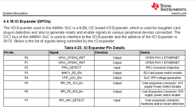

AM6442: How can I reset the PHY on SK-AM64B using IO expander
Part Number: AM6442
Other Parts Discussed in Thread: SK-AM64B, TCA6424A, TCA6424, TCA9538
How can I resent the PHY on SK-AM64B using IO expander?  Looks like I2C communications to 0x70 should somehow do the job.  Can you advise the instructions?

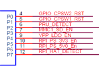

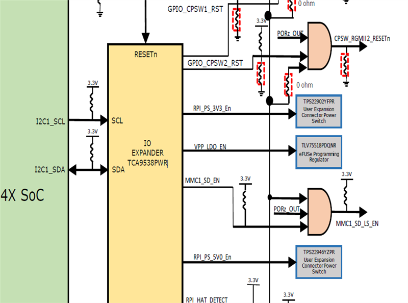

    This IO ex pander is not the TCA6424A but rather the TCA9538.  (Or is that part number incorrect and it is the TCA6424 as per block diagram?  I assume schematic is correct).
    It appears I don't see any i2c stuff on i2c bus 1.

  • Hi Timothy,
    I referred the schematics for SK-AM64B and found out that SoC_I2C1 indeed goes to TCA9538PWR. So I think your schematics is correct.
     Before we move forward, can you please specify which exact EVM you are using:
    1. https://www.ti.com/tool/TMDS64EVM
    2. https://www.ti.com/tool/SK-AM64B
    I am  assuming it is SK-AM64B. If so then we have to look at TCA9538PWR.
    On that note, would you like me to send you a cpiece of working code which basically sets one of the ports to HIGH?
    If that is the case, then which port/pin do you want to be driven HIGH?
    Vaibhav
