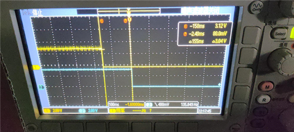

We used gst_tracer to monitor the performance, and observed high latency.
Whats worse, with photoresistors and oscilloscope,  the latency measurement was even bigger than 200ms, which is much bigger than the accumulated latency from the above picture.

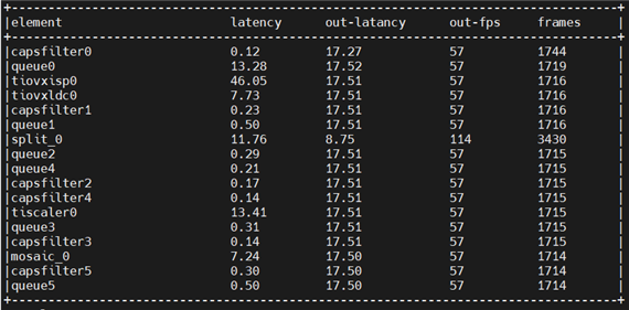

  • Hi Rahul,
    Thank you for the reply.
    Actually we are using the tiovxmultiscaler for cropping and downscaling already. It seems I didn't provide enough information in the initial post, but for the second sub stream, which currently involves tiscaler, we want to dynamically crop and upscale the video stream. Apparently tiovxmultiscaler alone is not capable of achieving our goal in this case.
    Currently, I think our pipeline have enough throughput to achieve 60fps, but the total processing time for each frame is too long, making the latency not acceptable. As mentioned in the question, I doubt the second sub stream cost too much time, postponing the tiovxmosaic to output the first frame.
    Some more test result are as follows:
    1. Getting rid of the tiscaler and related queue & capsfilter in the pipeline(basically the video stream is cropped in two different sizes by tiovxmultscaler, then spliced for output), the result from gst_tracer becomes:
    The pipeline is
    GST_DEBUG_FILE=/run/trace.log GST_DEBUG_NO_COLOR=1 GST_DEBUG="GST_TRACER:7" GST_TRACERS="latency(flags=element)" \
    gst-launch-1.0 \
    v4l2src device=/dev/video3 io-mode=5 ! \
    video/x-bayer, width=1920, height=1280, format=bggr12, framerate=60/1 ! queue leaky=2 ! \
    tiovxisp sensor-name=SENSOR_OX3C \
    dcc-isp-file=/opt/imaging/ox3c/dcc_viss_wdr.bin \
    sink_0::dcc_2a_file=/opt/imaging/ox3c/dcc_2a_wdr.bin sink_0::device=/dev/v4l-subdev2 format-msb=11 \
    sink_0::pool-size=2 src::pool-size=2 ! \
    queue leaky=2 ! \
    tiovxldc dcc-file=/opt/imaging/ox3c/dcc_ldc_wdr.bin sensor-name=SENSOR_OX3C ! \
    video/x-raw, format=NV12, width=1920, height=1280,framerate=60/1 ! queue leaky=2 ! \
    tiovxmultiscaler name=split_0 src_0::roi-startx=0 src_0::roi-starty=0 src_0::roi-width=1920 src_0::roi-height=1280 target=0 \
    src_1::roi-startx=0 src_1::roi-starty=0 src_1::roi-width=1100 src_1::roi-height=1200 target=1 \
    interpolation-method=16385 \
    split_0. ! queue ! \
    video/x-raw, width=1280, height=720, framerate=60/1 ! mosaic_0. \
    video/x-raw, width=640, height=720 ! mosaic_0. \
    tiovxmosaic name=mosaic_0 target=0 src::pool-size=4 \
    sink_0::startx="<0>" sink_0::starty="<0>" sink_0::widths="<1280>" sink_0::heights="<720>" \
    sink_1::startx="<1280>" sink_1::starty="<0>" sink_1::widths="<640>" sink_1::heights="<720>" ! \
    video/x-raw,format=NV12, width=1920, height=720 ! queue max-size-buffers=1 leaky=0 ! \
    kmssink driver-name=tidss async=false sync=false src-w=1920 src-h=720
    2. Removing the tiovxldc and the queue between tiovxisp and tiovxldc, the result from becomes:
    The pipeline is
    gst-launch-1.0 \
    video/x-raw, width=1920, height=1280 ! \
    tiscaler roi-startx=0 roi-starty=0 roi-width=800 roi-height=430 method=0 ! \
    queue ! \
    3. Applying modifications from the above two cases, the result becomes:
    The pipeline is
    gst-launch-1.0 \
    video/x-raw, width=1280, height=720 ! mosaic_0. \
    In the above cases, high lantency from tiovxisp can be observed. I think figuring out the cause can also help us cutting down the total latency of the pipeline. Could you please help us pinpointing the root cause?

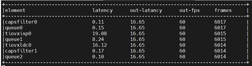

  • Hi Jianzhong,
    Actually the complex pipeline I posted earlier is based on a simple one we've been using for some time. It looks like this:
    gst-launch-1.0 \
    queue leaky=2 ! \
    video/x-raw, format=NV12, width=1920, height=1280,framerate=60/1 ! queue max-size-buffers=1 leaky=0 ! \
    The result from gst_parse is as follows, slightly larger than your assumption, but acceptable. With photoresistors and oscilloscope as measurement, the G2G latency is roughly 70ms.
    One thing to notice is that, if "sync=false" is added to kmssink, the result becomes larger. With "sync=false", kmssink should be comsuming incoming frames as soon as possible, somehow tiovxisp has larger latency in this situation.
    As for our complex pipeline, "sync=false" is essential, otherwise the stream will stuck. The result in my previous post shows that the tiovxisp has a large latency, similiar to the case above.
    Theoradically speaking, I doubt these aspects contributing the most latency:
    1. Unknown high latency from tiovxisp, maybe from tiovxmultiscaler copying the previous frame, or kmssink set to "sync=false", etc.
    2. tiovxmultisclaer has to copy the video for different sub stream.
    3. tiovxmosaic waiting for the second sub stream to finish, as tiscaler need some time to process the cropping and resizing.
    I think the second cause is mandatory, but the first and the third cause may be mitigated somehow? Could you please look into these problems?

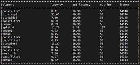

  • Hi Jianzhong,
    Some quick update: I tested your pipeline, but the result doesn't look good.
    Could this indicate that there's something wrong with the isp module?
    Huang Jingjie

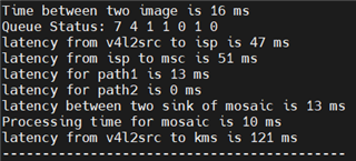

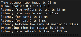

  • Some more updates:
    I wrote a python script to calculate the latency. The basic idea is binding sinks and srcs with callbacks, in each call back use the time library in python to generate timestamp.
    Part of the log is as follows:
    Here are some findings:
    1. It seems that the time between mosaic receive buffer from two sub stream is around 13~14ms, which is not as high as expected.
    2. The time between two images indicating the throughput of the isp. The number has a larger range, but roughly around 16.7ms to achieve 60fps.
    3. As I failed to get the src pad from tiovxldc, instead I calculated the latency between the src pad of tiovxisp and tiovxmultiscaler. The time is around 50ms, which is different from gst_tracer result. From the result of gst_tracer in previous post, the latency from tiovxisp, tiovxldc and the queue in between is much larger.

  • Hi Jianzhong,
    To evaluate the impact brought by our modification on kmssink, I did some experiment:
    Using python scripts, here are the result for each case:
    1. With our modified kmssink and the following pipeline, the result looks like this:
    "v4l2src name=v4l2src device=/dev/video3 io-mode=5 do-timestamp=true ! "
    "video/x-bayer, width=1920, height=1280, format=bggr12, framerate=60/1 ! "
    "queue name=queue0 leaky=2 ! "
    "tiovxisp name=isp sensor-name=SENSOR_OX3C "
    "dcc-isp-file=/opt/imaging/ox3c/dcc_viss_wdr.bin "
    "sink_0::ae-num-skip-frames=0 sink_0::awb-num-skip-frames=0 "
    "sink_0::dcc_2a_file=/opt/imaging/ox3c/dcc_2a_wdr.bin sink_0::device=/dev/v4l-subdev2 format-msb=11 "
    "sink_0::pool-size=2 src::pool-size=2 ! "
    "queue name=queue1 leaky=2 ! "
    "tiovxldc name=ldc dcc-file=/opt/imaging/ox3c/dcc_ldc_wdr.bin sensor-name=SENSOR_OX3C "
     "sink::pool-size=2 src::pool-size=2 ! "
    "video/x-raw, format=NV12, width=1920, height=1280, framerate=60/1 ! "
    "queue name=queue2 leaky=2 ! "
    "kmssink name=kms driver-name=tidss async=false "
    2. Adding "sync=false" to above pipeline:
    3. Switching to original kmssink, source code from gst-plugins-bad 1.20.7, the result is:
    In this case, the kmssink is outputing at 30fps. Time between two images arriving the src pad of tiovxisp becomes 34ms.
    4. With the setup from above, cropping the video into 1280x720 so that "force-modesetting=true" can be used, and add that to kmssink:
    "videocrop right=640 bottom=560 ! "
    "queue ! video/x-raw, width=1280, height=720 ! "
    "kmssink name=kms driver-name=tidss async=false sync=false force-modesetting=true "
    Here are some comparison with the complex pipe:
    1. With modified kmssink and the pipeline below:
    "tiovxmultiscaler name=msc "
    "src_0::roi-startx=0 src_0::roi-starty=0 src_0::roi-width=1920 src_0::roi-height=1280 target=0 "
    "src_1::roi-startx=0 src_1::roi-starty=0 src_1::roi-width=1100 src_1::roi-height=1200 target=1 "
    "interpolation-method=16385 "
    "msc. ! queue name=queue3 ! "
    "video/x-raw, width=1920, height=1280 ! "
    "tiscaler name=scaler roi-startx=0 roi-starty=0 roi-width=800 roi-height=430 method=0 ! "
    "queue name=queue4 ! "
    "video/x-raw, width=1280, height=720 ! mosaic. "
    "msc. ! queue name=queue5 ! "
    "video/x-raw, width=640, height=720 ! mosaic. "
    "tiovxmosaic name=mosaic target=0 src::pool-size=2 "
    "sink_0::startx=\"<0>\" sink_0::starty=\"<0>\" sink_0::widths=\"<1280>\" sink_0::heights=\"<720>\" "
    "sink_1::startx=\"<1280>\" sink_1::starty=\"<0>\" sink_1::widths=\"<640>\" sink_1::heights=\"<720>\" ! "
    "video/x-raw,format=NV12, width=1920, height=720 ! queue name=queue6 ! "
    "kmssink name=kms driver-name=tidss async=false sync=false src-w=1920 src-h=720 "
    2. With original kmssink, and changing resolution to 1280x720:
    "video/x-raw, width=1920, height=1280 ! “
    "video/x-raw, width=960, height=720 ! mosaic. "
     "video/x-raw, width=320, height=720 ! mosaic. "
     "sink_0::startx=\"<0>\" sink_0::starty=\"<0>\" sink_0::widths=\"<960>\" sink_0::heights=\"<720>\" "
     "sink_1::startx=\"<960>\" sink_1::starty=\"<0>\" sink_1::widths=\"<320>\" sink_1::heights=\"<720>\" ! "
     "video/x-raw,format=NV12, width=1280, height=720 ! queue name=queue6 ! "
    In this case, latency drop between two sub stream can be seen, because in the above pipeline tiscaler has less work load. The same drop due to less work load can also be detected in the processing time for tiovxmosaic. But other than these, the difference in the total latency between two pipelines is not as significant as your trail with IMX390.
    The queue status actually reflect how many timestamps are waiting to be read in each time queue. Each time the callback is invoked, it will store current timestamp into a FIFO queue for corresponding src/sink pad. When the last queue receives a timestamp,which corresponds to the sink pad of the kmssink, the callback will pop a timestamp from each queue and  calculate the timing.The first queue is for the src pad of v4l2src, and naturally larger number indicates higher latency. I didn't touch the setup for tiovxisp, so its work load stays the same. And for most of the cases, it has similiar throughput(around 17ms between two frames). Then the problem becomes: why in some cases tiovxisp has a late start as it won't start processing before several frames are sent by v4l2src? To be more precise, the only cases tiovxisp start working early is the first case I posted in the reply and your case with "force-modesetting=true".
    I think solving the above question would have huge impact on the total latency.
    Huang Jingjie

  • Hi Rahul,
    Thanks for the reply. I tried your suggestion and here are some results:
    1. The pipeline under test is
    "v4l2src name=v4l2src device=/dev/video3 io-mode=5 ! "
    2. The result from my python script is
    3. The result from gst_tracer is
    Improvement can be seen, some how the latency is still high. And it is worth noticing that the src/sink pad of tiovxisp has at least two buffers, as indicated by the parameter pool-size.

    2. The result from gst_tracer is
    I just noticed that the last column also indicates the frame number. For above case, 5 frames are in the pipeline between v4l2src and kmssink.
    3. The latency measured by is oscilloscope around 155ms ~ 180ms.
    Reducing queue does decrease the level of buffers in the pipeline, but reduced the framerate at the same time. It would still be better to let tiovxisp start as soon as possible.

    I'm assuming you are suggesting adding "queue leaky=2 max-size-buffers=1" between v4l2src and tiovxisp. Here are the pipeline and the result from gst_tracer:
    gst-launch-1.0 \
    video/x-bayer, width=1920, height=1280, format=bggr12, framerate=60/1 ! \
    queue leaky=2 max-size-buffers=1 ! \
    tiovxldc dcc-file=/opt/imaging/ox3c/dcc_ldc_wdr.bin sensor-name=SENSOR_OX3C \
    sink::pool-size=2 src::pool-size=2 ! \
    queue ! \
    video/x-raw,format=NV12, width=1920, height=720 ! queue ! \
    As the result indicates, more frames are dropped as the queue only accept one buffer. In this case, the latency produced by tiovxisp is still high, and significant lag can be observed in the video output.
