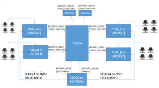

  • Hi, Suren
    Update, because the dts pin had a conflict before, after modification, the sound card can now be successfully detected.
    But I still can't record the wav file successfully, still having problem
    I think there are still some dts define that need to be modified, I added a block diagram to illustrate my purpose,
    Also please give me some advice. Thank you.dts_log.zip

  • Hi Suren,
    Let me clarify the current goals and issues.
    1.Our MICs is connect to AD2437 then convert to TDM32 format , send to TI S6234 via MCASP2
    2. Our clock chip will provide SCLK (24.576MHz) and LRCLK (48KHz) to TI 6234, so TI 6234 should be set to Slave mode
    So we plan to create a dummy sound card to record TDM32 data via MCASP2,
    but I think there are still problems with the DTS setting.
    Could you review the current DTS 2620.dts_log.zipsettings based on our request?
    Since we still can't record successfully, please help.
    Thank you.
  • Hi Edward,
    Our EVM board also uses AM62x as slave and the codec TLV320AIC3106 is the clock master.
    With this being said, please refer the below DTS file on how we have been able to have audio functional on both playback and capture.
    https://git.ti.com/cgit/ti-linux-kernel/ti-linux-kernel/tree/arch/arm64/boot/dts/ti/k3-am62x-sk-common.dtsi?h=ti-linux-6.1.y#n139
    We have the clock frequency to 12288000, dai-link property as bitclock-inversion and format as dsp_b.
    Can you try to use the same configuration as ours and see if it helps.
    Suren
