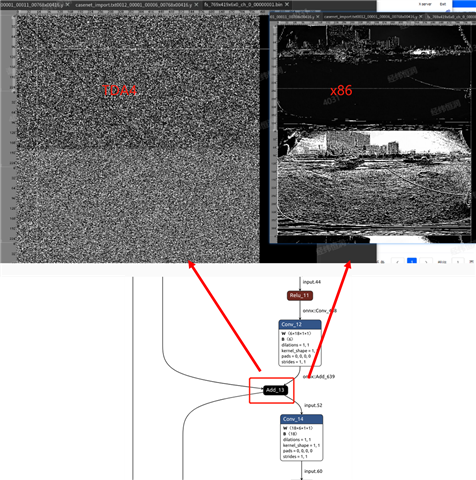

When we export the model to ONNX and deploy it on the TDA4 board (0804 version), we noticed inconsistencies between the feature maps generated on the x86 side and those on the board side. Upon comparing each layer of the network, we identified the issue occurring during the element-wise addition on the board side. After the addition operation, the feature maps exhibited a significant amount of mosaic artifacts.

  • Sorry, I might not have made it clear.
    The x86 marked in the image refers to the int8 feature map generated by the TIDL importer. The TDA4 in the image refers to the feature map saved by the TIDL node running on the board end. We compare the results of these two, and find a significant difference after the add layer.
    Due to company plans, we can only proceed with this on 0804.

  • We don't want to switch from TIDL SDK 0804 to the latest version 9.2. I might not have been clear enough, which may have confused you. I don't think the differences I mentioned are caused by TIDL SDK. What we want to know is why the results on the end are different from the TIDL results. In end inference, there is a mosaic problem in the feature map, as seen in the top left corner of the image. We hope you can help us locate the issue in 0804 or provide some debugging ideas.
    As mentioned earlier there could be possibility of functional miss match for eltwise add layer in 8.4 sdk version.
