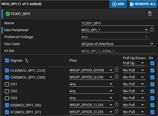

1. I found three spi examples of MCU domain in the SPI driver code(SPI_soc.c) of rtos sdk, but only two groups of SPI can be configured in the sysconfig tool.
How should they correspond here?
2. My configuration is as follows:
pinmux config:
code:
Does this configuration correspond correctly?

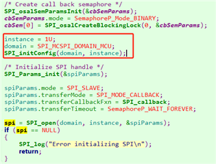

3.  After calling SPI_open interface successfully, I called SPI_transfer next.
The external chip sends messages to me at intervals of 200ms.
I call the SPI_transfer interface at intervals of 100ms, but the registered SPI_callback function is not called.
Then I find that I call the SPI_transferCancel interface after the SPI_transfer call, at which point the SPI_callback function is called, but transaction.rxBuf has no valid data.
Am I using SPI correctly?
